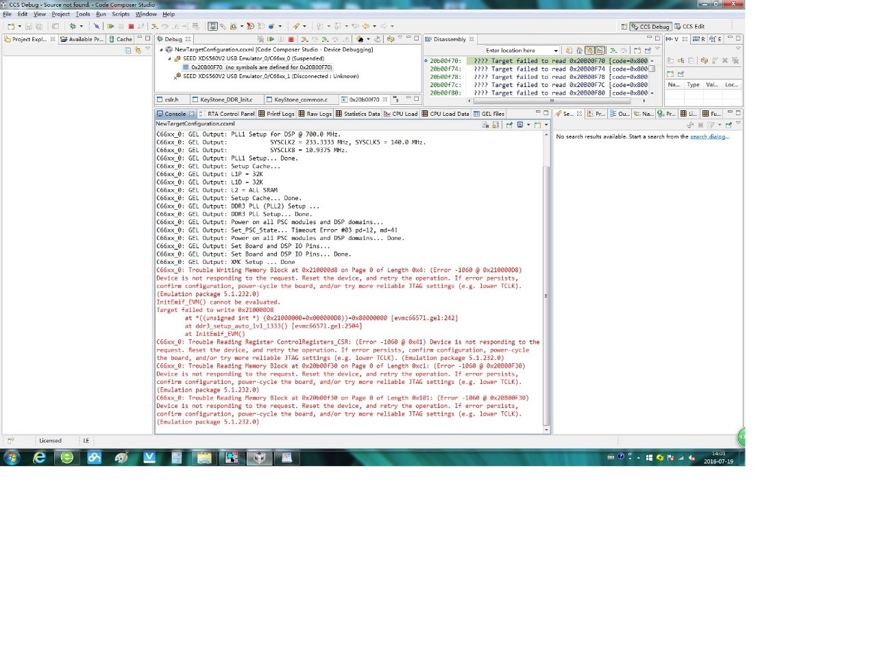

Test Conditions :Configure the evmc6657l.gel file in the STK_C6657 directory
1. JTAG is ok, Configure the GEL,Set the Set_PSC_State option,Prompt Error:
Set_PSC_State... Timeout Error #03 pd=12, md=4!
Set InitEmif_EVM for DDR3 initialization, the error: as follows:
InitEmif_EVM will set the statement spin-off, step by step, DDR3 can be set successfully, DDR3 can be used normally

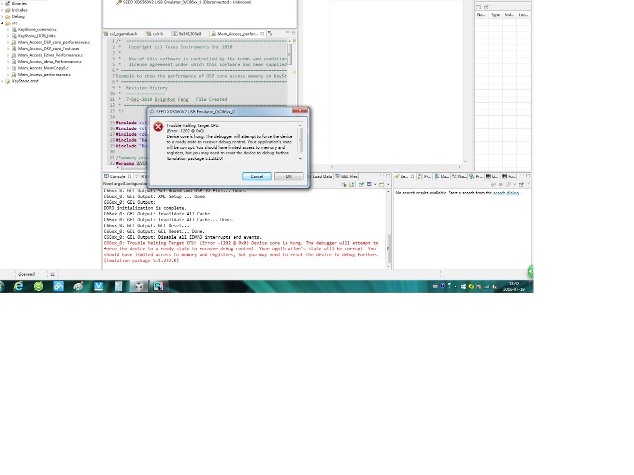

2. JTAG connection core0, load STK_C6657 catalog Memory_Performance project, without any changes. Load program,
Can not stop in the main, run directly fly,
Interrupt operation, do not stop, an error message:

  • Hello Honle
    I am not sure what exactly you try to do,  and I assume that you use TI 6657 EVM, so before we continue I want you to verify the following two items:
    1. You use the latest gel file from the CCS release.  I suggest using release CCSv6.1.3 and the gel file is in directory ccsv6\ccs_base\emulation\boards\evmc6657l\gel where your CCS is installed.   It is very important to verify that this is the correct gel file
    2. Make sure that you use a correct linker command file that defines correctly the device memories. Make sure that L1P, L2, MSMC memory and DDR are defined correctly.  It looks to me that your memory map is not correct.
    After verifying the above, and you still have issues, please attach the memory map to this posting.  If you solve your issue please report back here (and close the thread)
