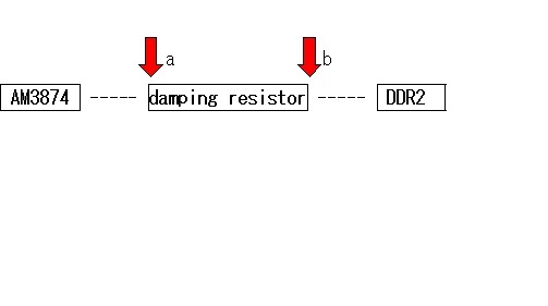

Way of the DDR2 compliance test when there is dumping resistance in DQS ?
Other Parts Discussed in Thread: AM3874
The circuit of our customer has dumping resistance between DDR2 and AM3874.
As for the DQS signal, what point is it right with to measure?
①The AM3874 side
②The DDR2 side

    Our customer measures the compliance test of DDR2 in the b side of the following figure.
    Is the measurement of which side of a or b correct on the compliance test of the DQS signal of DDR2?
    damping resistor:22ohm
    Shigehiro Tsuda
  • Shigehiro,
    TI does not recommend using serial terminator (damping resistor) on DQS traces, thus I can not advice from which side you should measure.
    For more details refer to AM387x datasheet, sections:
    9.13.4.1.1.1 DDR2 Interface Schematic
    9.13.4.1.1.9 DDR2 Signal Termination
    Pavel
  • Hi Pavel,
    Thank you for quick reply.
    Our customer confirms even the following, but the wave pattern of DQS does not seem to change.
    damping resistor = 0 ohm
    They cannot change the direct connection because their product board is completed.
    They think that they do not have any problem in 0 ohm when they think about an electrical characteristic.
    I think that I do not have any problem when I refer to the following of AM3874 datasheet because the definition of DQS is min 0 ohm to max Z ohm.
    Please tell me if this thought is wrong.
    Shigehiro Tsuda
  • Shigehiro,
    See note (5): No external terminations allowed for data byte net classes. ODT is to be used.
    ODT is internal termination (On-Die Termination). ODTs are integrated on the data byte net classes. They should be enabled to ensure signal integrity. For more info regarding ODT, see AM387x TRM, chapter 7 DDR2 and DDR3 Memory Controller
    Pavel
