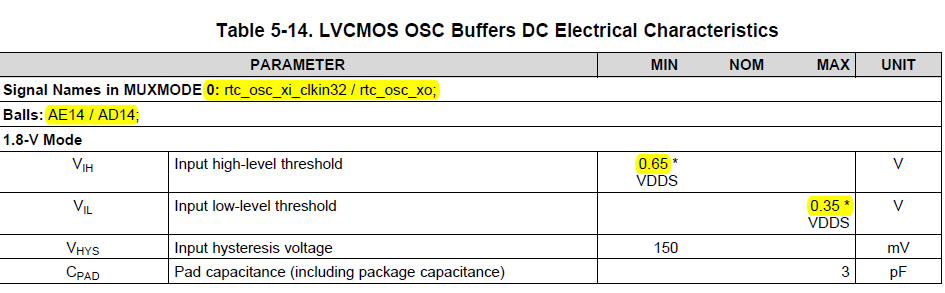

AM5718: OSC0 buffer electrical characteristics
Part Number: AM5718
We are checking whether clkin meet the 5ns rising time in datasheet, but did not find the rising time definition, only found RTC_OSC_XI_CLKIN32 and RTC_OSC_XO electrical characteristics as below snapshot in datasheet, how about that of XI_OSC0 and X0_SOSC0?
