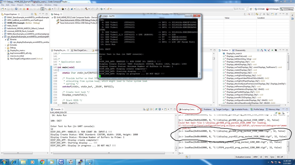

    When you run the example, it prompts you to load the .tigf files via CCS scripting console (CCS view ---->scripting console), the loading command is printed from the UART/CCS console, the command has the file name/location and what memory address to load, just run the example and you will see.
    Regards, Eric

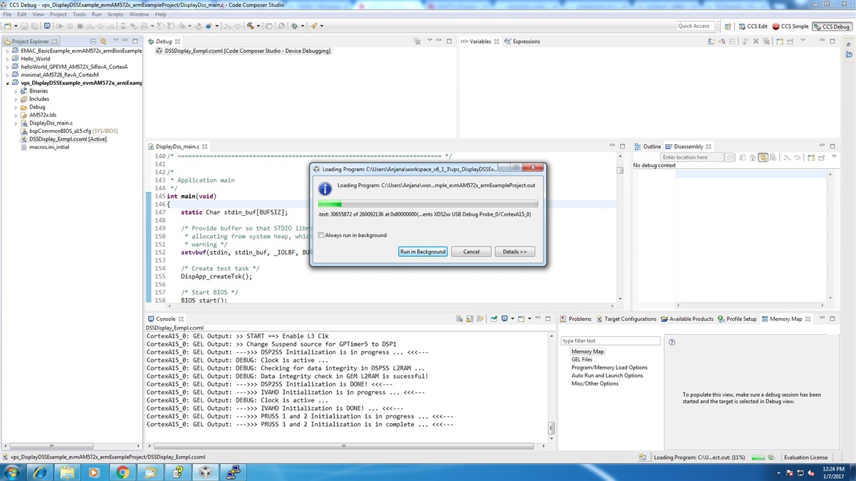

    After compling when i was loading the dss program it took time to load, as shown in screenshot below
    and after program loaded through XDS200 debugger, i run it in debug mode it gave the following error on CCs console
    Please helpme out where i am going wrong? is there any issue with project property as i had replaced the main file from the vps_idkAM572xExaomple_project with DSSDisplay_Main.c file.

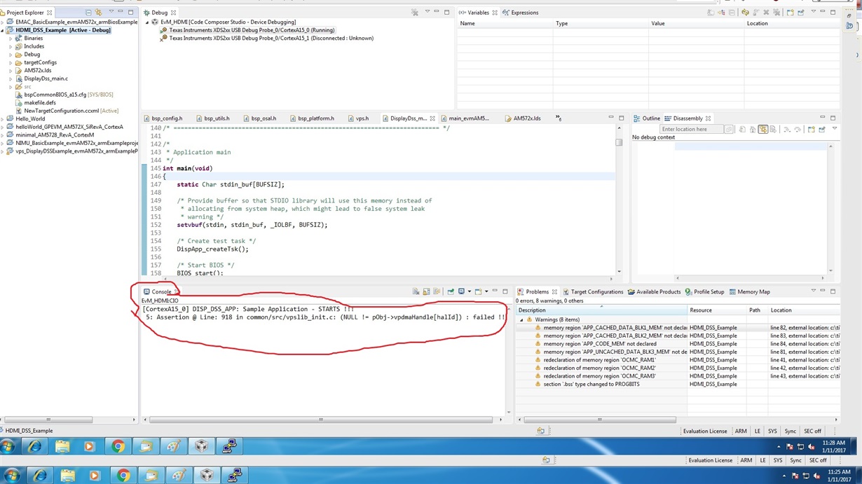

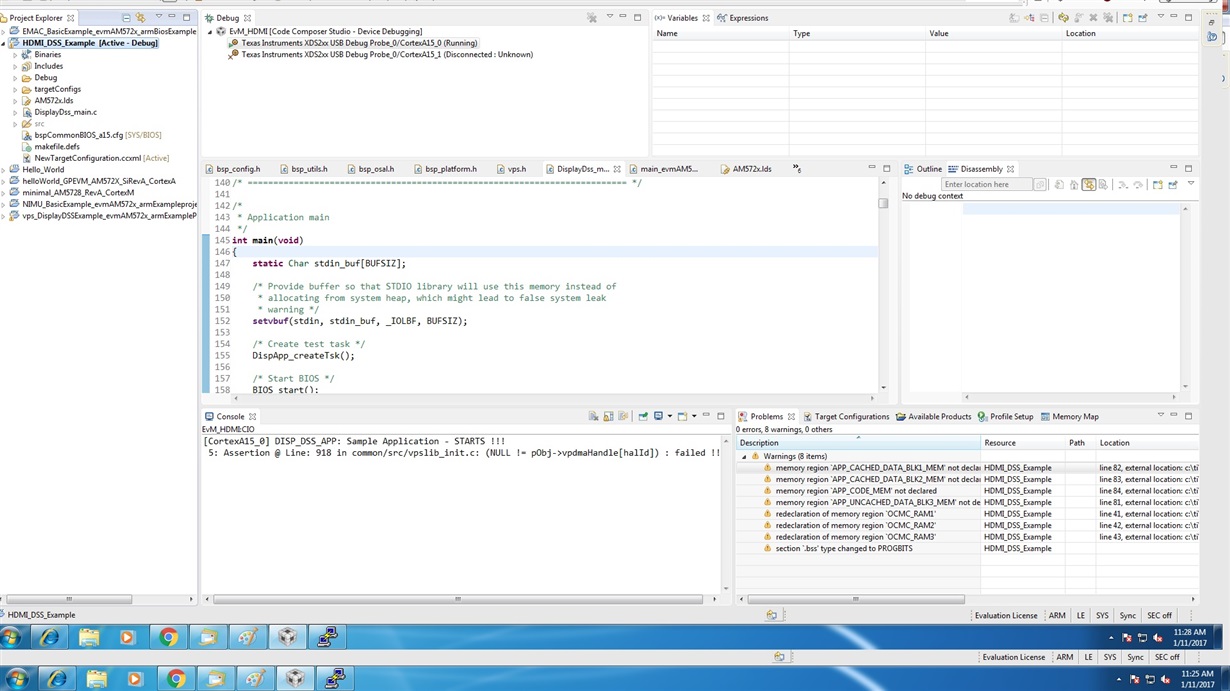

    Please help me to remove the below runtime error and warnings.
    5: Assertion @ Line: 918 in common/src/vpslib_init.c: (NULL != pObj->vpdmaHandle[halId]) : failed !!!
    Anjana Pathak

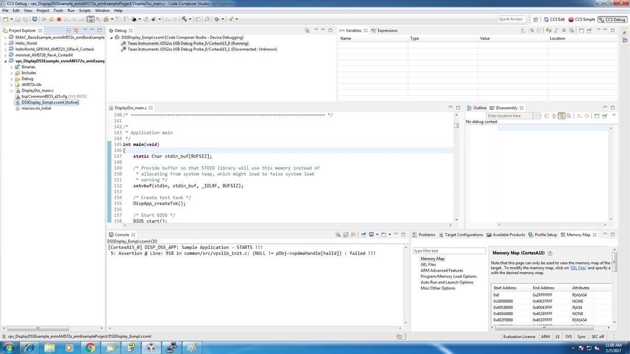

    Now there is no issue with building project but the error comes when i run this project. I am attaching the screenshot. I mentioned it in my last communication. Why assertion is failed?
    Anjana Pathak
  • I am looking into it and will let you know.
    Regards, Eric
    The assertion came from the failure of vpslib, there is no vpdma instance when configured. It looks that the pdk_am57xx_1_0_5\packages\ti\drv\vps\lib\am572x\a15\release or debug\vpslib was rebuilt when you use makefile option. And the build enviornment is wrong. It should have "DVPS_VIP1_BUILD -DVPS_VIP2_BUILD -DVPS_VIP3_BUILD" in the build option, for some reason this is gone and the re-built library has issue.
    Please:
    1. open a fresh command window and run pdksetupenv
    2. make vps_clean
    3. make vps ====> this will re-build all the libraries
    4. use this newly attached .txt file to create a CCS project, there is -DBOARD=evmAM572x added
    5. import into CCS, build and run
    Note
    1: In step 3 when compile vpshal.c you should see the build option mentioned above
    gmake[4]: Entering directory `C:/ti/PDK_AM~3/packages/ti/drv/vps/src/vpslib'
    # Compiling am572x:a15_0:debug:vpslib: hal/src/vpshal.c
    C:/ti_6_1_3/ccsv6/tools/compiler/gcc-arm-none-eabi-4_9-2015q3/bin/arm-none-eabi-
    gcc -MD -MF /ti/PDK_AM~3/packages//ti/binary/ti/drv/vps/src/vpslib/obj/am572x/a1
    5/debug/.deps/vpshal.P -DMAKEFILE_BUILD -Wimplicit -Wall -Wunused -Wunknown-prag
    mas -ffunction-sections -fdata-sections -c -mcpu=cortex-a15 -g -mfpu=neon -mfloa
    t-abi=hard -mabi=aapcs -mapcs-frame -D__ARMv7 -Werror -D_DEBUG_=1  -DBUILD_A15_0
     -DTRACE_ENABLE -DASSERT_ENABLE -DVPS_VIP_BUILD -DVPS_VPE_BUILD -DVPS_DSS_BUILD
    -UVPS_ISS_BUILD -UVPS_SIMCOP_BUILD -UVPS_ISS_ISP_DEF -DVPS_VIP1_BUILD -DVPS_VIP
    2_BUILD -DVPS_VIP3_BUILD    -DSOC_AM572x -IC:/ti_6_1_3/ccsv6/tools/compiler/gcc-
    arm-none-eabi-4_9-2015q3/arm-none-eabi/include -I. -I/ti/PDK_AM~3/packages/ -I/t
    i/PDK_AM~3/packages//ti/csl -I/ti/PDK_AM~3/packages//ti/drv/vps/src/common -I/ti
    /PDK_AM~3/packages//ti/drv/vps/src/osal -I/apps/apps_nonbam/inc -I/ -I/common  -
    o /ti/PDK_AM~3/packages//ti/binary/ti/drv/vps/src/vpslib/obj/am572x/a15/debug/vp
    shal.oa15fg hal/src/vpshal.c

  • I did the changes and it works, But how do i load 8.tigf file. I tried  the below steps to load tigf file.
    1. Run the loaded program in debug mode. got the below msg.(no sd card connected to the target)
    Load 4 YUV422I_YUYV video frames of size 1920x1080 to location: 0x0x80c00000
    Trying to Load buffer from SD card.
    Couldnot Load buffer from SD card.
    waiting for 1 min to load buffer from scripting consolePress any key (in UART console) after loading buffer
    loadRaw(0x80c00000, 0, "C:\\display_yuyv422_prog_packed_1920_1080.tigf", 32, false);
    2. i used loadRaw command to load the above tigf file to the given location from Scripting Console of CCS. please look into the attached image.
    3. Selected option 11 and 12 DSSVideo2
    4. got green yellow and pink vertical strips display on HDMI screen.
    I donot now weather this is correct or incorrect....How do in modify or edit those tigf file?......or how do i create new tigf file?

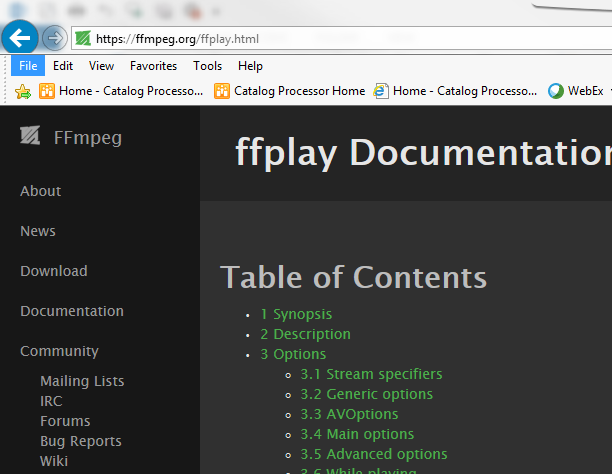

    I am getting following error while accessing this site
    This site can’t be reached
    The webpage at ffmpeg.org/documentation.html might be temporarily down or it may have moved permanently to a new web address.
    ERR_TUNNEL_CONNECTION_FAILED
    Anjana Pathak
  • can i use any bit map file to display on HDMI...
    Anjana Pathak
  • The site is not mainteined by TI and I just tried it worked for me.
    Regards, Eric
  • TI is up and running...see screen shot below:

    The way you build, load outfile and run are correct. The way to using script console to load two video files are also correct.
    The GP EVM only has a 800x480 LCD, so you can see the left upper corner of the video. If the HDMI is connected to a 1920x1080 display, you should see the full video. Other than that, the display on LCD and HDMI is the same.
    For example, test case 0 is YUV to LCD. Test case 11 and 12 are for HDMI + display using the same YUV video as in case 0 (progressive or interrleaving). Our test team and developer had tested them, I don't have a HDMI setup.
    You have the ffplay or avplay to play the video (4 frames) to see what it contains. Then does case 0 look right on LCD? What case 11 or 12 show on TV?
