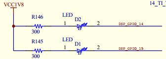

      2.If the Schematic diagram about LED as following :
      You can see DSP_GPIO_14 and DSP_GPIO_15 control the LED,how can I write the code ?

    See the pdk_c667x_2_0_3/packages/ti/drv/gpio source code. You can use either GPIO_toggle() or GPIO_write():
    * @brief Toggles the current state of a GPIO
    * @param index GPIO index
    extern void GPIO_toggle(uint32_t index);
    * @brief Writes the value to a GPIO pin
    * @param value must be either 0 or 1
    extern void GPIO_write(uint32_t index, uint32_t value);
    Connected this way, the led will be on, when GPIO is low (0) & led will be off, when GPIO is high (1).
