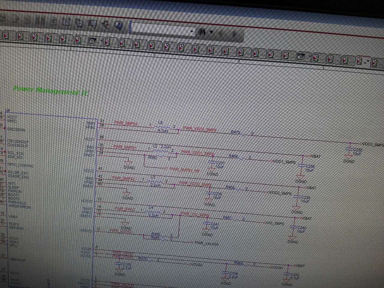

TPS65910: AM335x GP EVM step-up DC/DC circuit error
Part Number: TPS65910
Hi Sir,
      In the schematic of AM335x-GPEVM,I found a mistake about the step-up DC/DC circuit of PMIC TPS65910.The device Pin31 provides one step-up converter,but it is a buck circuit construction in the reference design ,please help to confirm,many thanks!
