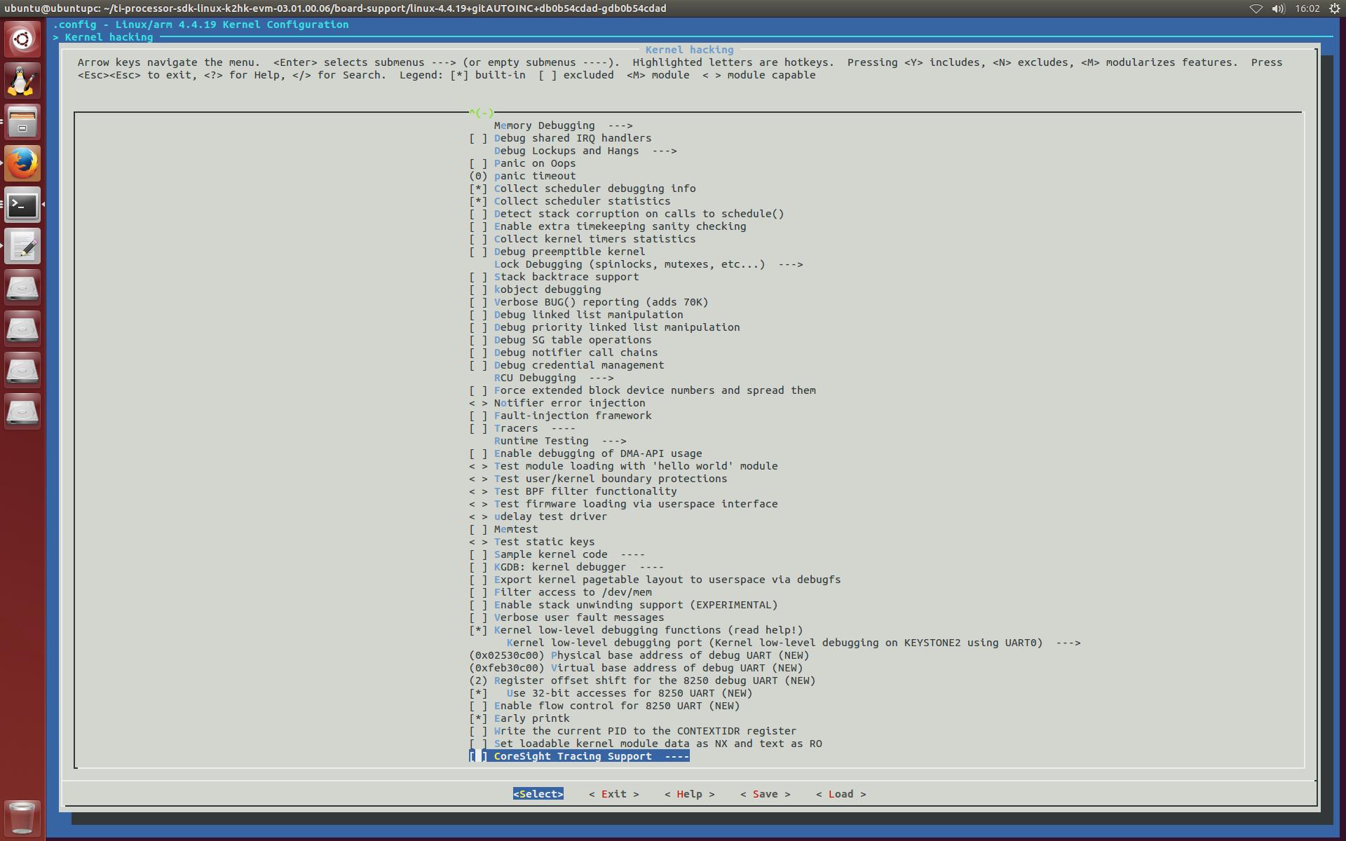

From this page
I had set the kernel using 'Kernel low-level debugging functions' and 'early printk'.
But I still had no more things output after 'booting the kernel'.
So how should I do to debug further?  How to enable CONFIG_DEBUG_LL? Could anyone help me?

  • Hi Feng,
    You can add CONFIG_OMAP_LL_DEBUG_UARTX=y (where X is the uart you use as a debug console) in your defconfig file.
    Its a common mistake to use different uarts as debug consoles in u-boot & kernel ( dts file). So verify that both u-boot & kernel use the same uart.

  • Hi Yordan,
    I had added the below command in /arch/arm/configs/tisdk_k2hk-evm_defconfig file
    CONFIG_OMAP_LL_DEBUG_UART0=y
    CONFIG_KEYSTONE_LL_DEBUG_UART0=y
    And used the following commands to build the new llinux kernel file and dtb file
    make ARCH=arm CROSS_COMPILE=arm-linux-gnueabihf- disclean
    make ARCH=arm CROSS_COMPILE=arm-linux-gnueabihf- tisdk_k2hk-evm_defconfig
    make ARCH=arm CROSS_COMPILE=arm-linux-gnueabihf- zImage
    make ARCH=arm CROSS_COMPILE=arm-linux-gnueabihf- keystone-k2hk-evm.dtb
    make ARCH=arm CROSS_COMPILE=arm-linux-gnueabihf- modules
    make ARCH=arm INSTALL_MOD_PATH=/mnt/usb/ext4 modules_install
    Also I used the following commands to build new boot monitor file
    make ARCH=arm CROSS_COMPILE=arm-linux-gnueabihf- clean
    make ARCH=arm CROSS_COMPILE=arm-linux-gnueabihf- image_k2hk
    Then I used these latest file to boot through USB mass storage device. But noting more was printed out after  'Uncompressing Linux... done, booting the kernel'.
    And could you specify how to confirm the number of UART port used by UBOOT and Linux?
    As I know, the default UBOOT and Linux for K2H EVM is UART0 which is the same as my own board.
