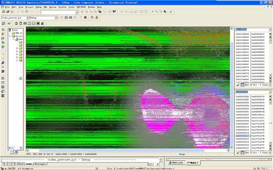

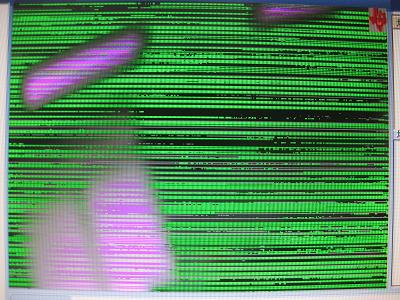

My video source(Aptina MT9D131) generates 720p video in YCbCr 8-bit format, with external sync signals (Hsync, Vsync). I have configured DM6437's VPFE in YCbCr 8-bit mode. Now I captured the image successfully when I configured the pixel-clock of sensor to 40Mhz. But failed to capture when I increase the pixel-clock to 60Mhz for more frame. Attached is the snapshot of captured video from DDR memory directly. At the same time, I connect the output of cmos sensor to DM365 board, it captured successfully by 60Mhz PCLK. I probed the PCLK and VINDATA lines, and didn't see any issue.
Refer to PCLK in spru977c.pdf, the maximum pixel clock rate of DM6437 VPFE is 71 MHZ in Normal mode. Is there any register I need to set? Is there any relationship to bandwidth of DDR or VPFE?

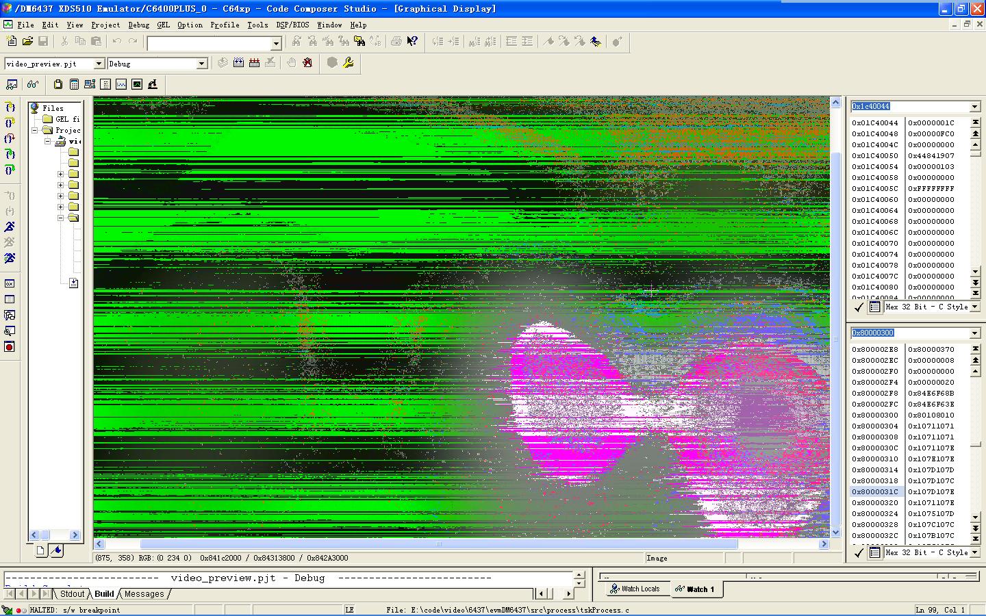

    We have changed the polarity of PCLK by set the PCLKINV bit to '1'. Attached is the snapshot of captured video. I think it's not useful.

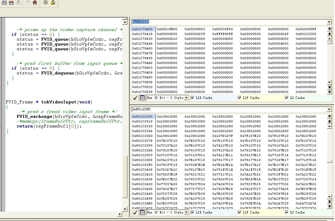

    Attached is the configuration of CCDC register and the YUV data file captured in memory when the PCLK is 60Mhz.

    Refer to Maximum Data Throughput on page 79 of spru977c.pdf, the read bandwidth of CCD controller is about 10MB/s. We've calculated simply the data throughput of our 4:2:2 YUV data, is 1280 x2 x 720 x (5~6) frame when the PCLK is 40Mhz. It seems like nearly to 10MB/s. If we increase the pixel-clock to 45Mhz for more frame, the image is fail to captured at some pixel. if  to 60Mhz, the image is fully fail to captured the whole image.
    I just want to konw if the bandwidth refered above is sticking point to the problem.

  • We checked the PLLC1 Multiplier to x22 again and found SYSCLK1 is set to 297Mhz on our board. The VPFE can capture the 720P at about 12fps successfully when PCLK is 60Mhz after we adjust  the SYSCLK1 to 594Mhz by set the ratio of PLLDIV1(/1).
