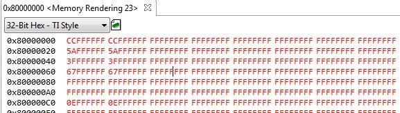

    Today I've been at the customer and we did some debugging. In the Excel sheet we have entered the parameters from the 1600 speed grad DDR part. We tried the EMIF at 400 and 666 MHz (via uboot). But with both settings there are problems with the upper byte of the 32 bit EMIF interface. This is how the memory looks like in CCS after filling with 0xffffffff:
    When using the GEL file from the AM5718 IDK on the customer board, the EMIF seems to work fine if DDR is configured for 400 MHz. But when using a higher speed than 400 via the GEL, the memory error is back. So it looks like the HW is OK, only a config issue.

    Is it expected that all EMIF_PHY_RD_DQS_SLAVE_RATIO values are 0? Also in the Excel sheet the RD leveling seems to be disabled. Why?
      Robert

    I've double checked leveling and the above pattern is visible with RW/WR leveling performed.
    Without it - the EMIF_READ_WRITE_LEVELING_RAMP_CONTROL (0x4C00 00D8) RDWRLVL_EN bit clear - there is "random" output.

  • We found the root cause. In the layout two pins have been swapped, causing incorrect addressing for one of the DDR3 devices.
    Thanks for your help!!
