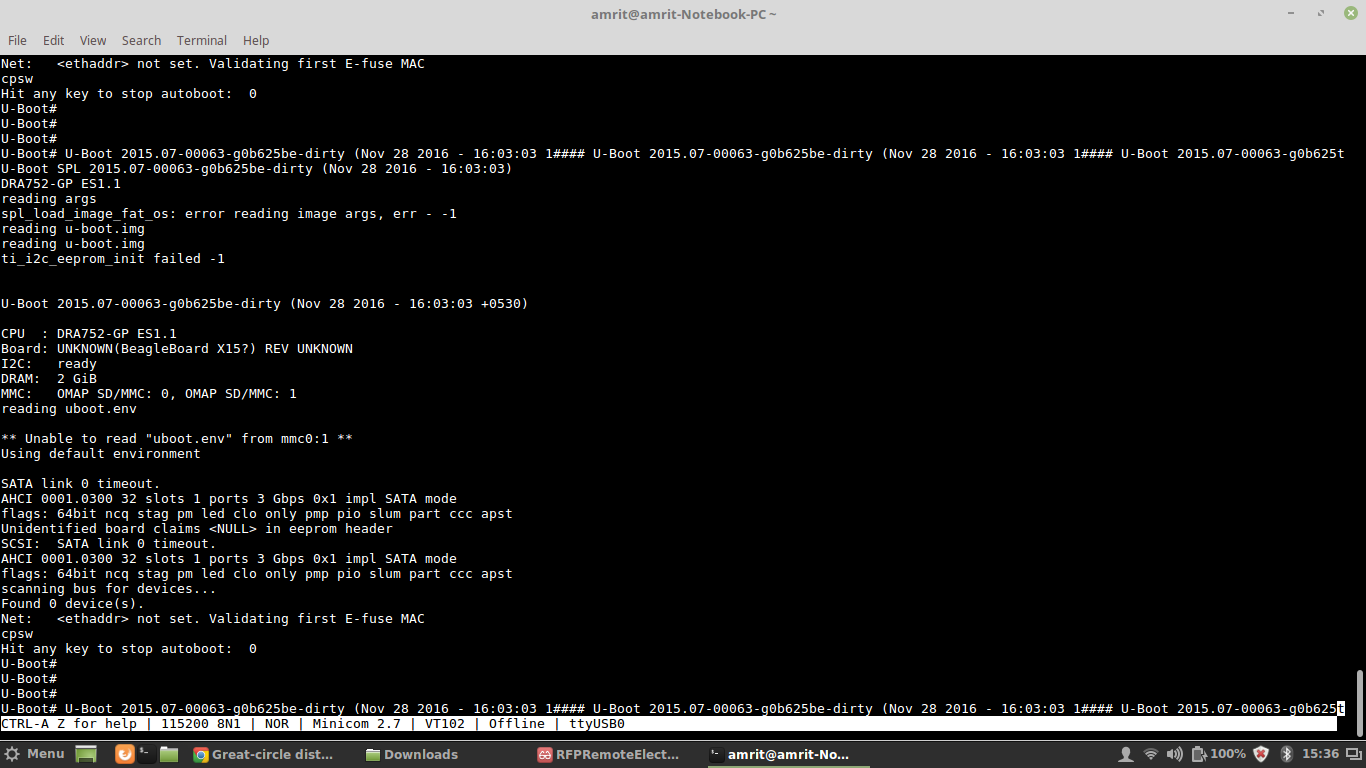

AM5728: Unable to load kernel
Part Number: AM5728
In our AM5728 Based board, we are facing an issue that the U-boot process is initiated but the kernel is not able to load and the whole process comes to a hault.
On giving reset to the processor through an external switch, the U-boot process starts but again haults after giving same messages. Pls find the screenshot attached.
