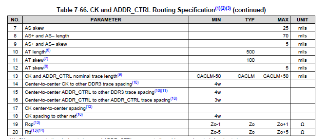

I have a qustion about Datasheet of AM335x for DDR3.
It is described in Table 7-66 of Datasheet below
Can you explain about No.17 "CK center-to-center spacing" ?
Is it space between CK and CKn ?
and Why it is empty ?
