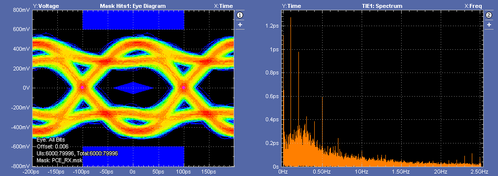

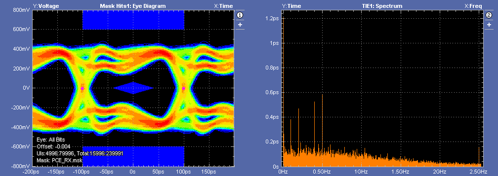

Team,
On an AM5718 customer design there is Pericom PI7C9X2G404SL PCIe bridge. But in Linux the bridge is not always detected. If we limit PCIe to GEN1, the bridge is always detected and operates stable.
Attached log files for the working and one for the non-working case (both using GEN2).

  • We were able to capture the eye diagram but we did not use any special test pattern or procedure.  We did get a very expensive 33 GHz scope loaned to us with solder down probes.  Since we were able to get the link into Gen2 sometimes, we kept initializing the link until we got Gen2 then collected the eye diagram.  This exercise showed us the VOD from the FPGA to the AM5728 was low causing mask violations in the middle of the eye.  We were able to increase the VOD and fix the mask violations.  The eye from the 5728 to the FPGA looked ok, it could be better, but ok.  I also noted on another thread that we discovered the Reset sequence for the PCIe susbsystem was not well documented in the TRM.  Fixing that issue has allowed us to be able detect that Gen2 failed to initialize and reset and retry.  Usually after no more than 4 retries, the link comes up and is stable.  That thread is here:  https://e2e.ti.com/support/arm/sitara_arm/f/791/t/574129
    Here are the eye diagrams we collected.
    5728 to FPGA
    FPGA to 5728
