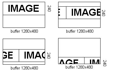

    I tried the values! And my image come with a half of height than I want….
    The image come as 1280x240 and it is walking into my buffer… something like the figure below
    Some idea?
    Thanks!
  • I tried another configuration:
    OUT_SIZE = 0x1D60500 // 1280x470
    RSZ_CNT = 0x06C900
    And the image stopped to rotate! But come with half of height than I want yet…

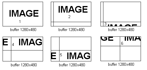

  • I tried another configuration again:
    OUT_SIZE = 0x1E00500 // 1280x480
    RSZ_CNT = 0x06A500
    vert coeff = {0,256,0,0,-6,246,16,0,-7,219,44,0,-5,179,83,-1,-3,130,132,-9,-1,83,179,-5,0,44,219,-7,0,16,246,-6}
    (These values I got on psp video sample source file (resize))
    Now the image rotate and walk! But come with the height than I want .
    I think than fault some sync....
