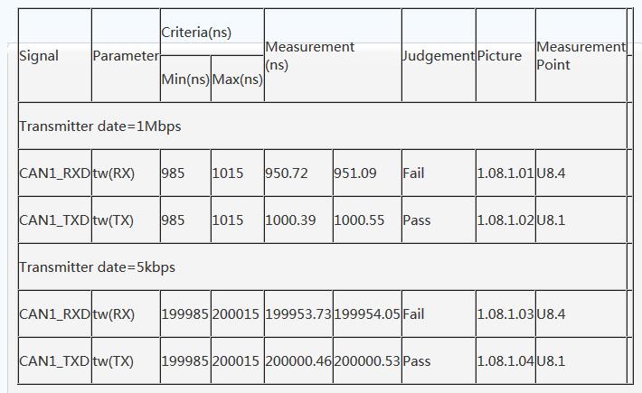

AM5718 DCANRX period is H-15 to H+15 ns, is this required by AM5718, or required by CAN protocol?
I checked it on AM335x, AM437x datasheet, it is H-2 to H+2 ns. seems this parameter specific to devices.
Now, my customer use SN65HVD251 with AM5718, test result as below, the RX timing can't meet AM5718 requirement.
My question, can this device work with AM5718?
Check with SN65HVD251 FAE, the timing output from SN65HVD251 can't be ajusted.
