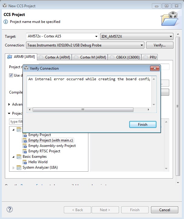

     I am new to this TI processor and CCS. I am first time using this setup. i am unable to boot the board with provided SD card. I have gone through the process of creating prebuild image with TI Rtos SDK. on different SD Card but unable to get result on teraterm with baud rate of 115200 terminal dosent show any thing.
also when i run the ccs 7 and on selecting XDS100V2 USB Emulation and after clicking verify button, it display internal error occured.

    As per your suggestion i have connected 5volt 10A power supply. still no luck. on development board industrial LED2(blue) industrial LED3(glows) but no output on tera term.....
    ccs display following error when we select XDS100V2 USB Emulation and goes for verification "An internal error occurred while creating the board config text."

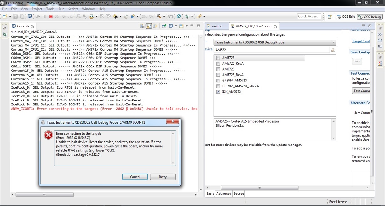

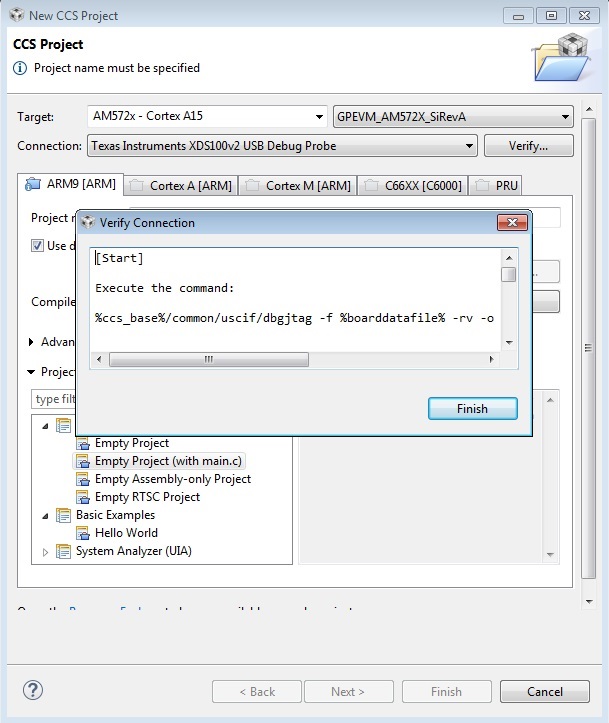

  • hi again,
                   my kit is "TMDXIDK5728"
                   when I select IDK_AM572x and "XDS100V2 USB"
                   It shows following screen:
    but when i select : when I select GPEVM_AM572x_sirevA and "XDS100V2 USB" following message is displayed
    with following message on box:

  • Which CCS version do you have? The version recommended for AM572x devices is 6.1.3.
  • hi Biser,
    I have ccs 7.
    Thanks & Regards
    Nikhil Muley
  • hi Biser,
    I have CCS 7.
    Thanks & Regards,
    Nikhil
  • The version recommended for AM572x devices is 6.1.3.
  • hi Biser,

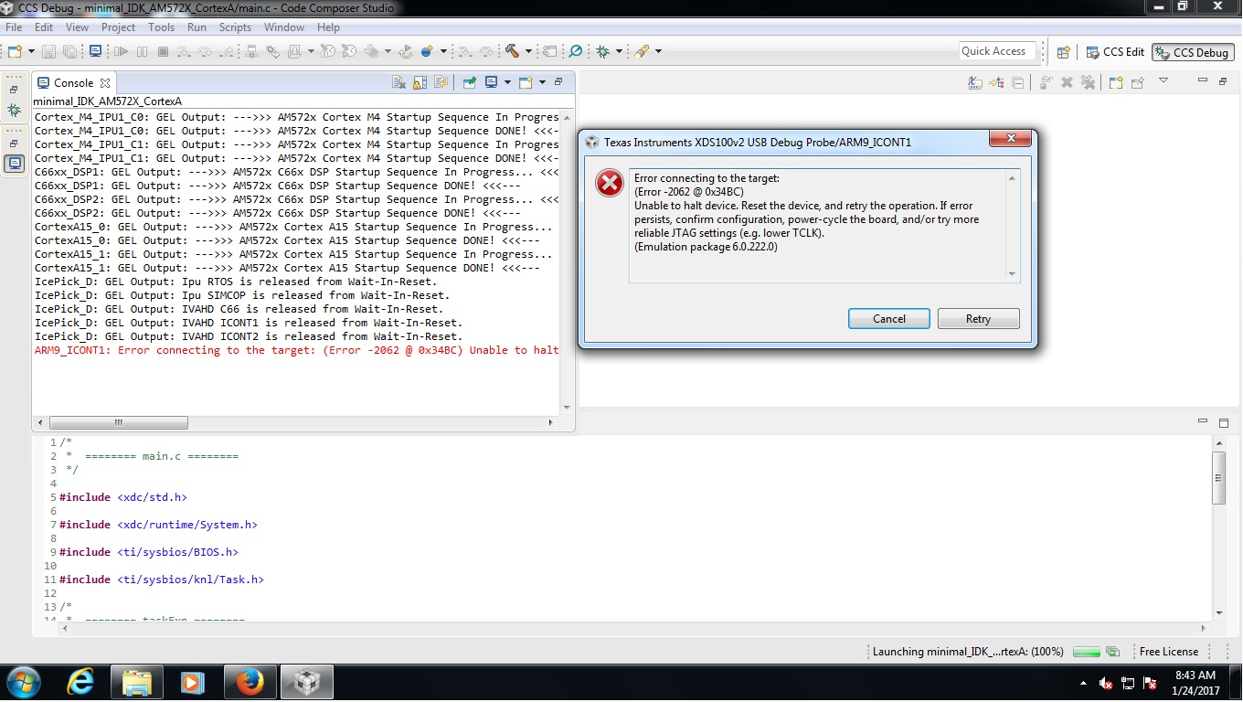

    As per your suggestion i have installed "CCS 6.1.3". i have insert the SD card with ti RTOS as per procedure given in "processors.wiki.ti.com/.../Processor_SDK_RTOS_Creating_a_SD_Card_with_Windows". Teraterm dosent show any message.
  • I have already notified the RTOS team. They will take this issue from here.

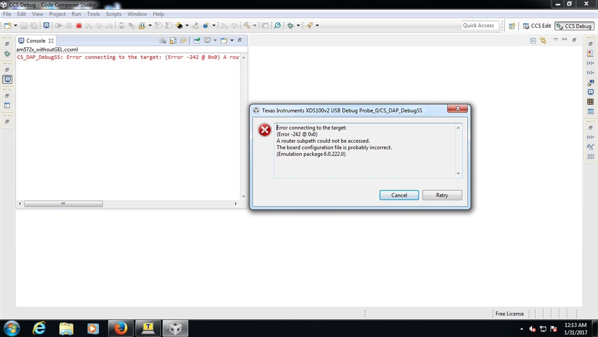

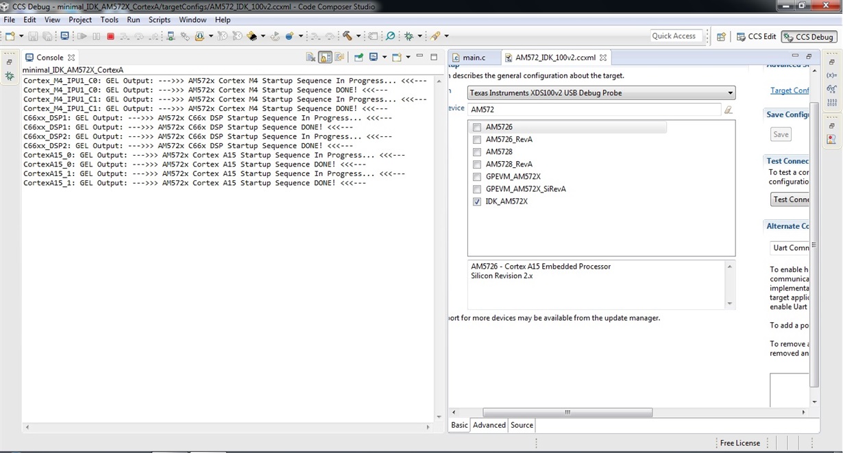

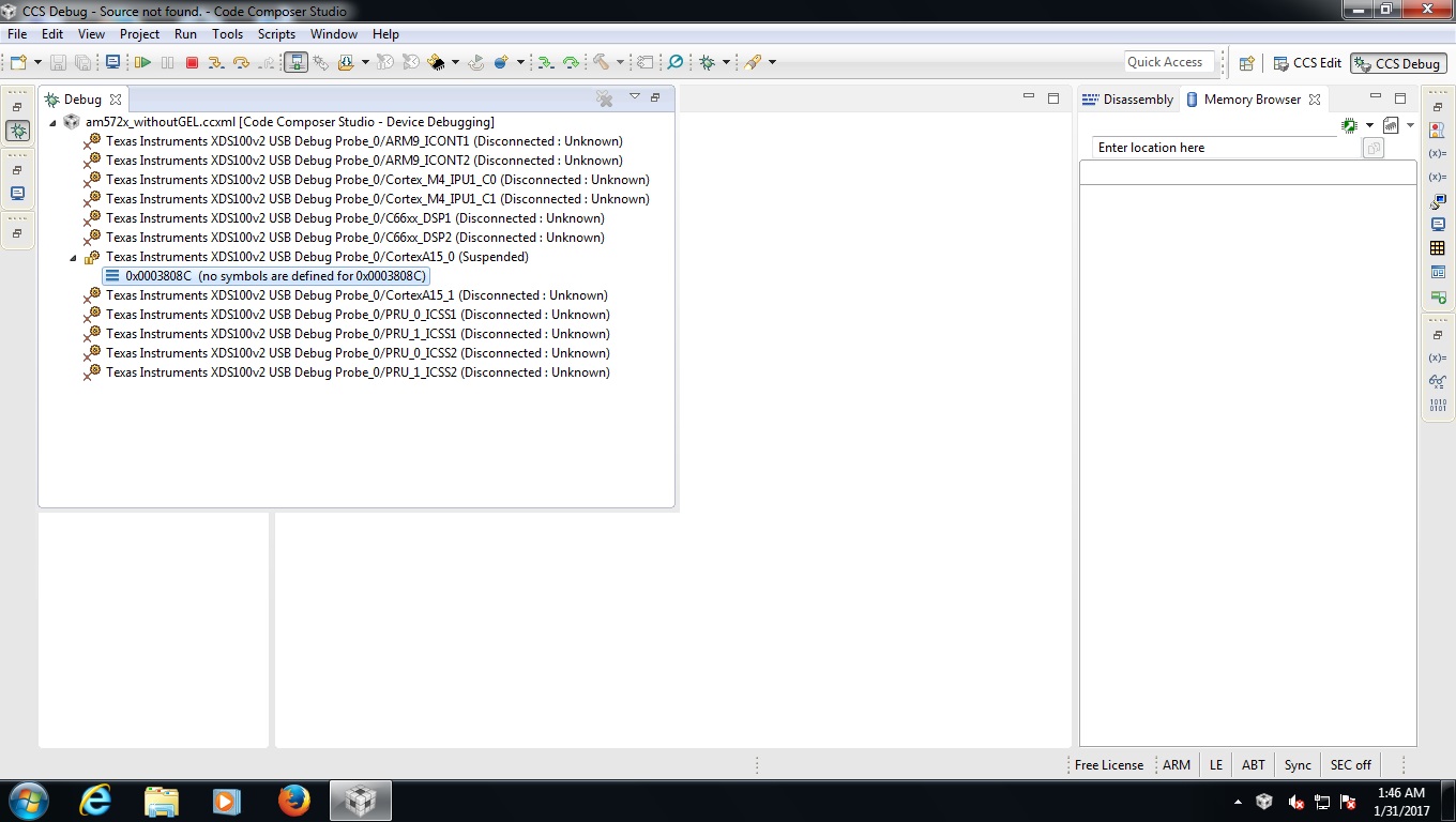

  • hi Eric,
    I have followed the process from wiki " processors.wiki.ti.com/.../AM572x_GP_EVM_Hardware_Setup" .
    I am unable to understand what I am doing wrong in the process.
    Can you provide the full CCS console log when you connecting to A15, here is my test for a Rev 1.3B AM572x IDK EVM for your reference:

                 Thanks for providing your ccs target configuration file, on your target configuration file I have changed path from "c:\ti_6_1_3" to "c:\ti" and then make this file as active and then build the project.
    I have got following result.
    After Clicking on connect to Target Button.
    Following Screen Display
    I have also attached my demo project file ... please take a look at it let me know what went wrong.
    workspace_v6_1_3.rar
    Thanks & Regards,
    Nikhil Muley
  • hi Eric,
    I got my mistake that i was doing ...... while connecting target I was connecting to arm 9 ...... when i select cortex A15_0 core ........ i got the result that you have posted above .....
    but Still my RTOS Sd card doesn't boot

    Keep you original CCXML file which has GELs associated to connect to the EVM. Please create a new ccxml use the same xds200 JTAG, but in device select "AM5728", not those IDK or GPEVM, so this ccxml will not have any GELs.
    When you copied the diagnostic files and boot from SD card, as you see nothing from UART, please use this new ccxml to connect to the A15 core (there is no GEL to intialize the SOC again, this already done by MLO). If you see the A15 PC is at 0x3_xxxx address, it means the boot didn't work. If you see PC is at 0x4xxx_xxxx, that is boot happens, may be the UART breaks?
    Another way is to use the UART test examples with your original ccxml to initialize the SOC, and to see if you see anything on UART.
    Regards, Eric
  • Hi Eric,
          Thanks for explanation. i have created a new ccxml with device selection as "AM5728" and after  that connection was tested which was ok. But when I try to connect to A15_0 core i got following error:
    How to remove the above error ?
    Thanks & Regards,
    Nikhil Muley

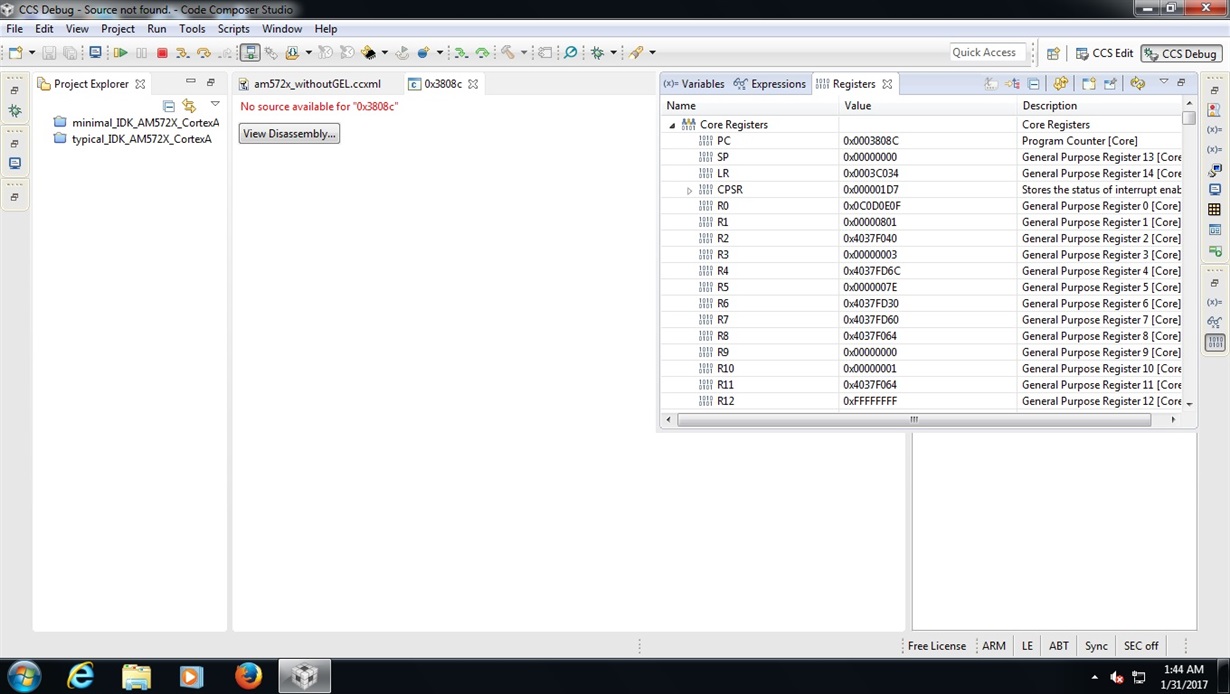

  • hi Eric,
                when i try to connect the A15_0 without GEL and without TI RTOS SD Card.
    Program counter is on following location:
    Thanks & Regards,
    Nikhil Muley
    when i try to connect the A15_0 without GEL and without TI RTOS SD Card, PC at 0x3_xxxx looks right.
    As we are debugging why there is nothing on UART, can you "i try to connect the A15_0 without GEL and WITH TI RTOS SD Card", where is the PC?
    Regards, Eric
