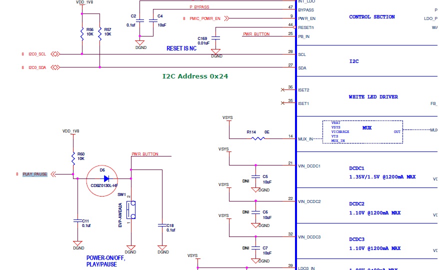

We have custom board based on AM3351 and TPS65217 along with battery. Our requirement is the board should boot if the power button pressed down and hold it for more than 3 seconds, otherwise the  PMIC will enter into sleep mode(To maintain RTC time) after shutdown the processor. If power button is not pressed for continuously 3 seconds, we are configuring the RTC alarm2 register to shutdown the processor after 1 second and then PMIC will enter into sleep mode.  But we are facing below problem.
After configuring alarm2 register, the PMIC takes approximately 3 second to shutdown the processor instead of 1 second. I have attached the part of code where we putting PMIC into sleep mode in SPL.  Below is the log.

The above log is eMMC boot. But the same SPL binary if you boot it through UART, it is working properly (i.e) PMIC enter sleep after 1 second.
CCCCCCCCCCCCCCCCC
U-Boot SPL 2015.07-g46c915c963 (Jan 21 2017 - 16:56:16)
RTC doesn't run. Restart RTC
RTC: Status reg: 0x82 ctrl reg: 0x01
Preparing pmic sleep mode
RTC Status reg: 0x02 ctrl reg: 0x01
Get RTC year: 17 mon/cent: 01 mday: 21 wday: 00 hr: 11 min: 52 sec: 15
Set Alarm at DATE: 2017-01-21 (wday=6) TIME: 11:52:16
Read back Alarm2 reg DATE: 0017-01-21 TIME: 11:52:16
PMIC will go to sleep in 1 second(processor is powered off)
