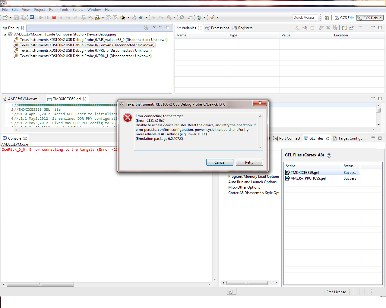

Hello Champs,
Recently customer have purchased a TMDSICE3359 Evaluation Board (ICEV2). He is not able to get it booted from SD card. He did not get SD card from the vendor. Hence he purchased an micro SD card, Sandisk 32GB.
Then he copied the MLO and App of SYSBIOSSDK-IND-SITARA 02_01_03_02 to SD card in Windows7. With this MLO and App, he could connect to minicom. Linux commands were displayed in minicom.
Then he assumed that the booting was from SPI flash. In order to boot from SD card, we erased the SPI flash using lsdkflasher.out through Code Composer Studio.  Then he tried to boot from SD card. It was not working.
Then he tried to re-flash the image (downloaded from SYSBIOSSDK-IND-SITARA 02_01_03_02 )  into  SPI. Then an error occurred in Code Composer Studio.. Error connecting to the target(Unable to access device register). Without connecting to the target, we are not able to flash SPI.
He has checked the USB cable also. Will this be any problem in hardware?
Thanks.
