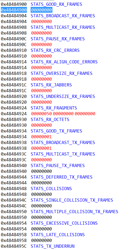

    I think the TDA2e or PHY is dropping packets. Can you please send PHY datasheet link and contents of registers 0x4848_4900 to 0x4848_498C?
     This should tell us if any packets received on TDA2e.

    2.Registers  0x4848500c onwards:
    3.Registers 0x48484900 onwards:
    Please also find the PHY data sheet link below:
    ww1.microchip.com/.../ksz9021rl-rn_ds.pdf
  • Ok, this explains. If you see register 0x4848_4910 (CRC errors) it is non-zero, so basically there is issue with PHY configuration IO delays and so it doesnt give correct data to TDA2E.
    Can you please check in PHY data manual if there any delay setting for Gbps link?
    Also do you comment out PHY delay configuration from vayu_init() function?

    I modified the task delays in gmac configuration and instead of MAC_CONNECTION_TYPE_RGMII_FORCE_1000_FULL i put
    MAC_CONNECTION_TYPE_RGMII_DETECT_INBAND as pGMACSWConfig->macInitCfg[i].macConnectionType.After that please
    find the register configuration(0x48484900) attached wi th this:
