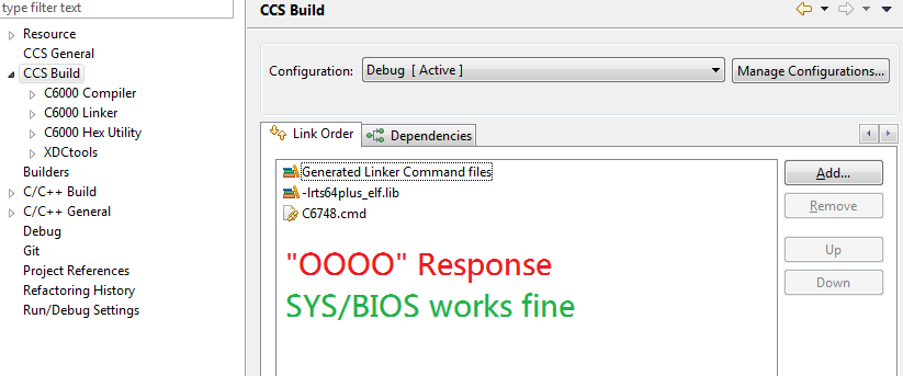

I'm having trouble reading from the NAND flash chip (MT29F4G16ABADAH4) on the LCDK board, and I'm looking for suggestions.
I send a basic READ ID command (0x90, 0x20), but instead of reading back the normal ONFI code (ascii "ONFI")  I get an ascii "OOOO". The memory browser actually shows "ONFI" but it seems that the data isn't being properly shifted out of the NAND cache register.
A few additional facts:
  • When I compile TI's NANDWriter_DSP project I do not have this problem - even if I add SYS/BIOS I can still flash a boot image just fine
  • I'm using some of the same code from TI's NANDWriter_DSP project in my project
  • I'm using compiler version TI v8.1.0
  • My project uses TI-RTOS. However, this issue occurs even before a call to BIOS_start()
Strangely, when I create a copy of the NANDWriter_DSP project with SYS/BIOS and try a READ ID command then it works just fine -- but when I use the same code in my SYS/BIOS project it compiles differently and does not shift properly (as described above). I've attached screenshots showing the difference in disassembly.
Code for reading from NAND flash: devID16[i] = *addr_flash;
I've searched the compiler settings of both projects looking for some difference that could account for this but I came up empty-handed. It feels like I'm missing something obvious.
Any help or insight on this would be immensely appreciated. I'm happy to provide additional information and clarification as needed.

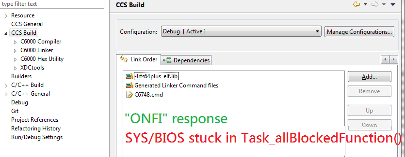

    I did stumble upon a way to "fix" the problem by adjusting the link order of the build, but that fix causes another problem. Let me explain:
    When I link "lrts64plus_elf.lib" before the "Generated Linker Command files" produced by (I assume) XDC for SYS/BIOS, then I do get the expected "ONFI" response shifted out of the NAND cache register. Success! ...Or so I thought.
    Unfortunately, this change also seems to disable TI-RTOS. Tasks fail to run and the system seems to idle and do nothing -- stuck in the SYS/BIOS function Task_allBlockedFunction(). I have attached a couple screenshots for clarity.
    When all the entries are removed from the Link Order list, the behavior is identical to the "OOOO" case (second screenshot).
    As I am unfamiliar with the inner workings of XDC and TI_RTOS, I must admit that I have very little clue as to what is happening here. Any thoughts or insight you can offer would be greatly appreciated.

  • I can shed some light on ...
    David_Askew said:
    In the current configuration, you will notice that rts64plus_elf.lib is linked in last, resulting in a "OOOO" response to the READ ID operation. Note that this behavior is the same when rts64plus_elf.lib is removed from the project entirely. If instead you link rts64plus_elf.lib first, a proper "ONFI" response is observed, but SYS/BIOS fails to call any tasks, etc.
    If you do not tell the linker which RTS library to use, it automatically chooses one for you.
    I can think of two possible reasons why you see different behavior based on where the linker sees the RTS library on the command line.
    One, the same function is present in multiple libraries, and the wrong one is getting linked in.  To see if this might be occurring, add the option --scan_libraries to the link.  If the same function is present in multiple libraries, you will get a diagnostic that shows you which libraries have the function, and which one gets used.  Read more about --scan_libraries in the C6000 assembly tools manual.
    Two, causing the linker to see inputs in a different order causes things to be allocated to system memory in a different order.  And this difference in order either masks or unmasks some other problem.  Let's hope this is not the case, because it is much harder to track down.
    Thanks and regards,
    -George
  • George,
    Thanks for the advice about --scan_libraries, it's a handy tool. I noticed a few key differences between the two builds.
    There are three symbols – "_stack", "_c_int00", and "_auto_init_elf" – that are pulled from different sources depending on link order. In the version where rts64plus_elf.lib is linked last, these symbols are pulled from "boot.ae674", but when it's linked first those symbols are pulled from "rts64plus_elf.lib".

  • David,
    Why do you have both "rts64plus_elf.lib" and "rts6740_elf.lib" included in your project? That sounds dangerous. Why is just rts6740_elf.lib not sufficient?
    There are many things that can go right or go wrong in trying to re-create someone's failing project build. I have been in the position of having to do that in the past, and worked for days without success. Speaking out of turn for Rahul, the best way to get a solution from Rahul, if possible, will be for you to create a zip'd archive project of the failing file sets (and possibly working file sets, separately) including library files and header files and all of your local source files. Using even minor-release-different libraries can completely change the result. Please confirm it builds and fails, or passes as the case may be.
    RandyP
  • Randy,
    It is SYS/BIOS that includes "rts6740_elf.lib" automatically. I discovered (while trying to debug the NANDwriter w/ TI-RTOS project) that I could get the NAND operation to work properly if I explicitly linked "rts64plus_elf.lib" – the same library used in the original NANDWriter project.
    It's probably easy to miss now, as this thread has become lengthy, but I have stated several times that the result is exactly the same whether I link "rts64plus_elf.lib" last, or if I don't link it at all. The following truth table should sum it up.
    Build #1
    rts64plus_elf.lib 1st, rts6740_elf.lib 2nd
    Build #2
    rts6740_elf.lib 1st, rts64plus_elf.lib 2nd
    Build #3
    rts6740_elf.lib ONLY
    (link order unspecified)

     I agree with you that it's almost certainly an issue of different libraries causing different results. My question is why does build #3 cause NAND-related operational problems with the EMIF? Also, how would I even go about debugging such a problem if I don't have access to the libraries' source code?

  • I managed to isolate the source of the problem, though I'm hesitant to make any claims about why it caused the bug. Perhaps you might be able to shed more light on that.
    The problem seemed to stem from where I defined the flash memory regions for CS2 and CS3. Your project defined them in the linker command file, "NANDWriter_DSP.cmd", whereas I specified them in a custom platform which ultimately meant they were defined in the TI-RTOS auto-generated linker file "linker.cmd". Removing those entries from the custom platform and then manually adding the memory definitions to my linker script seems to be the solution.
    Perhaps those definitions need to be located in the same linker file that defines the ".aemif_mem" section (rather than in linker.cmd)? Though it's not entirely clear to me why that would be. I'm hoping you might have some thoughts on the matter.
