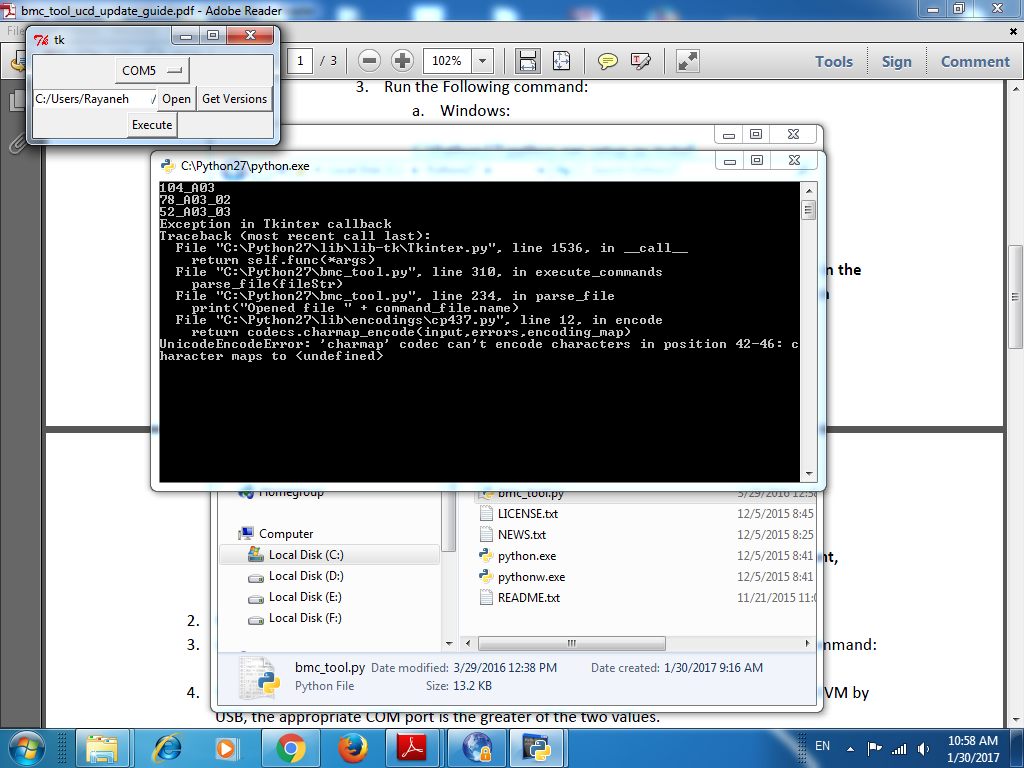

My board is 66K2H14 rev4. I tried to find it's IP address but I saw "SOC power failure" I tried to update UCD module based on "bmc_tool_ucd_update_guide" file but I faced some problems:
*my PC is 64 bit and pyserial is just 32 bit, I installed python 2.7.11 but I couldn't installed pyserial 2.6 I searched a lot but I can find nothing good.
*I unistalled python 2.7.11 64 bit and installed python 2.7.11 32 bit  and then I could install  pyserial 2.6 too.
*everything was ok and I found bmc_tool.py file difficulty and I ran it I could find the version of the current UCD module versions but I could not update the UCD module it have some errors
I don't know what is the problem I have some guess:
1-my PC is 64 bit but I installed 32 bit Python--->if I want to install 64 bit python how can I install pyserial as it is 32 bit?
2-the file "bmc_tool.py" is old and I don't know where I can to find the the new version of it! could you please sent me the final version for 66K2H14 rev4?
and finally if you have some suggestion could you please tell me?
