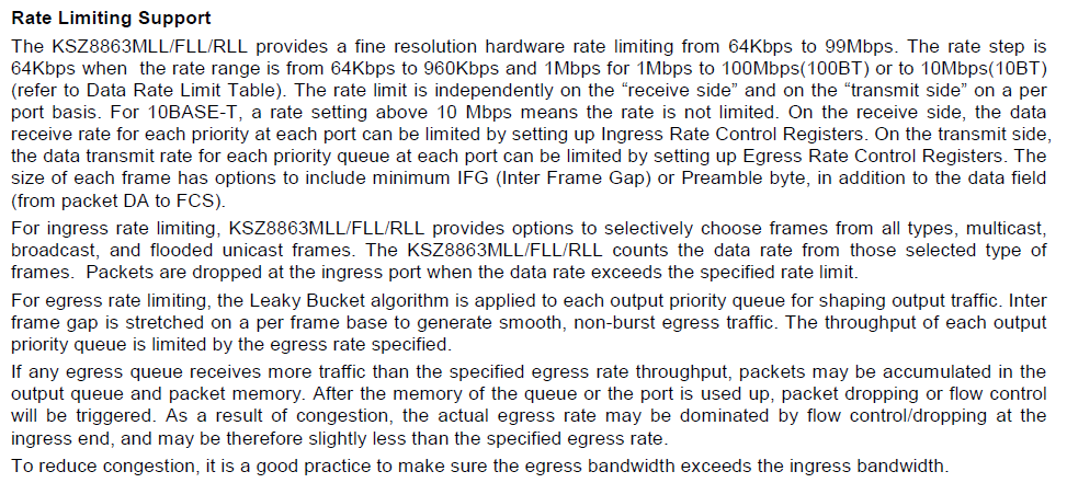

  • Ingress rate limiting only affects broadcast and multicast packets. The quote you listed from the wiki along with the TRM for the part is the current documentation available.

  • About the rate limiting. I am bring the capability description from the HW we currently use with our other product,
    Please specify what out of the above is/isn't supported. Cheers
