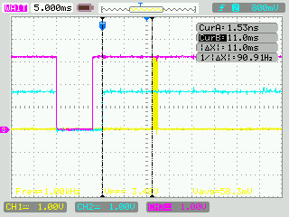

Our issue is trying to bring the system back up after issuing a "reboot" command from linux. The issue is only present on our board when ROM tries to load SPL from eMMC. ROM loading SPL from sdcard works as expected.

    • When we issue a reboot command from software the kernel goes down for reboot and issues a rstout pulse.
    • The system goes down for reboot and immediatly comes back up. reading SPL from the sd card.
  • When executing from the eMMC
    • the system goes down and issues the same RSTOUT pulse as in the SD card case.
    • After 11 milliseconds the ROM code tries to fetch something from eMMC, I see the MMC_CLK lines activate.
    • After only a few mmc clocks the mmc clock and all signals from the AM572x to the eMMC go to idle state.
    • After 3 minutes in this state the reset pulse happens again and the system starts up normally running SPL, u-boot and kernel from the eMMC.
    • we are trying to boot from a FAT partition in the main area of the eMMC, we are not using the boot sections of the eMMC.
Below is a scope image of the failure condition.
In addition to the signals below I have confirmed that 3.3V power to the eMMC remains stable and at 3.3V all the way through the reset event.
Yellow is the mmc2_clk
light blue is the input to the PMIC pin NRESWARM, driven by RSTOUTn
magenta is the PORZ input signal to the AM572x.
What can we do to eliminate the 3 minute pause and get our system to reboot directly from eMMC without delay?

  • Do you have SYSBOOT15 pulled high?
    Do you have pullups on the eMMC pins (RST#, CLK, CMD, DATx)?
    Is your system reset (i.e. the one that drives PORz) connected to the eMMC reset? If so, have you written the one-time programmable bit inside the eMMC to permanently enable that pin? It is disabled by default.
  • This sounds so familiar to another issue wherein we had a customer that had the BOOTMODE pins messed up- the 3min of 'idle' suggests its trying to boot from some other device (like SPI, USB?) and it's not finding it; then when it bails out now the BOOTMODE pins are in the right state and you see success.  Please check those pins as per Brad's suggestion above.
    -Dave
  • Setting the eMMC rst function bit appears to have resolved the issue.
    For future reference to anyone else...
    u-boot has a command line function to do this mmc rst-function <dev> <value>
    Dexter
