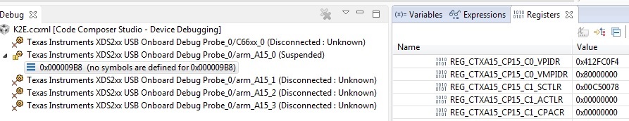

Hi to all!
I have a custom board based on K2E_EVM. On my board DDR3 placed directly on PCB, but not on SODIMM,
64-bit, no ECC. Memory chip is MT41J128M16-125 on 1600 MHz. I get latest u-boot source code and compile it with
small change in DDR init only part. (Add two structures with static DDR parameters for my chips). Than I load u-boot.bin
in on chip memory of Cortex-A15 Core 0, at address 0xC000000 as stated in u-boot/boart/ti/k2s_evm/README.
U-boot started, and print init sequence (see below) and go in infinite loop after board_init_f() in hung().
CPU Is working in this moment and I can attach JTAG and connect to Cortex-A15 Core 0 in CCS. I can see DDR3 addresses
from 0x80000000 and other memory. It seems to be correctly working and copy u-boot. But SP register has value 0x0BADCODE.
I don't know how I can debug this issue. Please give me any advise. I can init DDR via gel file from CCS and can fill it some values
in great range. The same parameters I use in u-boot code. And I disable DXEN bit in KS2_DDRPHY_DATX8_8_OFFSET as stated in datasheet.
register.

Here the CCS window after I connect to CPU in this moment:
CCS window screenshot link. Can't attach large image.

  • Hi Vladimir,
    I've forwarded this to the SW experts. Their feedback should be posted here.
    BR
    Tsvetolin Shulev
  • Hi, Vladimir,
    After you click free-run in the CCS, are you able to hit any key to get u-boot prompt?
    Rex
  • Hi, Rex!
    Thank you for your answer.
    No, u-bot does't boot to command line prompt.
    It is spinning in bad code handler (as I suspect).
    Update:
    Board by default boot in I2C master mode. And I can start u-bboot only via CCS without any additional initialization with gel-file.
    May be this information will be useful.
  • Hi to all!
    I fix some issues in DDR3 registers settings as stated in sprabx7 spreadsheet.
    At this moment I can boot board to the u-boot command line prompt. But can do it only when I call from CCS this function: Disable_MMU();
    After I load u-boot.bin and do free run. Here the boot log:

    1) Rex, can you tell me, please, that boot mode on your EVM?
    2) I have I2C mode only (I2C ROM is clean), without possibility change it :( and may boot ROM made some changes of registers before I start loading the u-boot.bin?
    3) Can you tell me, please value of REG_CTXA15_CP15_C1_SCTLR register, when you connect to board before loading gel-file and u-boot.bin image? In my case it is:  0x00C5107D - MMU is enabled (bit0 == 1).
    If I clear MMU bit and set REG_CTXA15_CP15_C1_SCTLR =  0x00C5107C and then load u-boot.bin - all work fine!!! I have a console prompt and can test DDR3 range from 0x80000000 - 0xB0000000 without any errors many times.
    4) May be you can tell me how I can test DDR3 from CCS more complexl than u-boot test?
    I don't have any ideas more :(

    1) Rex, please can you tell me value of REG_CTXA15_CP15_C1_SCTLR register value, when you connect to board in No boot mode, before loading u-boot.bin image? I always see that it is:  0x00C5107D - MMU is enabled (bit0 == 1).
    Update:
    To boot from I2C:
    I convert spl/u-boot-spl.bin into GPH image and write it in i2c eeprom and also write u-boot-spi.gph in SPI NOR. After power up board I see that CPU ROM code start reading whole image from i2c but CPU not started :( and stalled. (CCS can't connect to A15_0 core)
    If I disable MMU in SCTLR and than load spl/u-boot-spl.bin via emulator my system bring up completely and I have a u-boot console.
