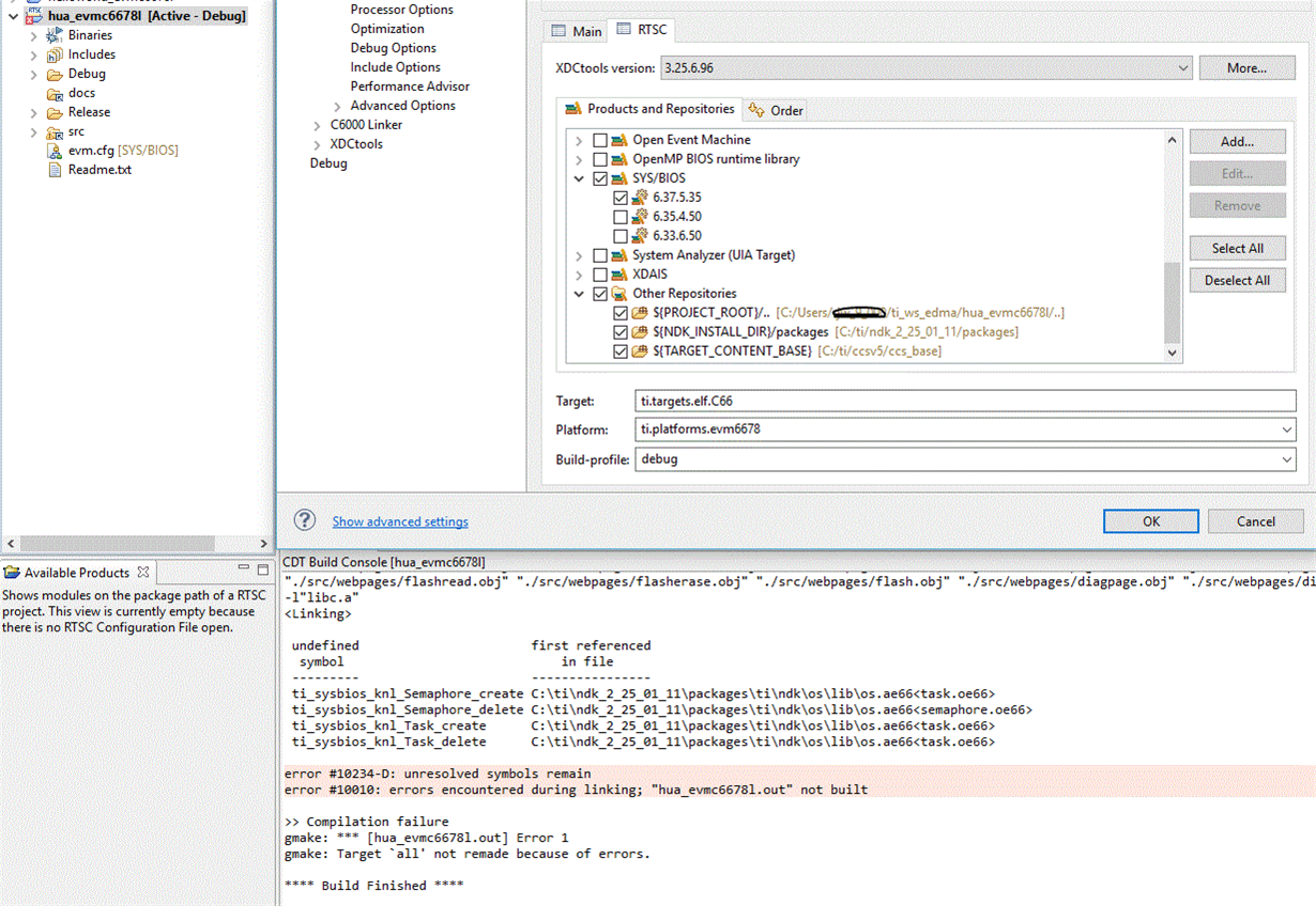

I try to build HUA demo on my computer for (Windows 10, CCS 5.5) C6678 evm. First of all, the old ndk_2_21 was not accepted by CCS 5.5. A new ndk_2_25_01_11 is installed. In the building, the following line needs commented out according to a e2e post:
//    sin1.sin_len    = sizeof( sin1 );
I've updated xdc and bios to 3.25.6.96 and 6.37.5.35 respectively. But there is a linker error:
<Linking>
undefined first referenced
symbol in file
ti_sysbios_knl_Semaphore_create C:\ti\ndk_2_25_01_11\packages\ti\ndk\os\lib\os.ae66<task.oe66>
ti_sysbios_knl_Semaphore_delete C:\ti\ndk_2_25_01_11\packages\ti\ndk\os\lib\os.ae66<semaphore.oe66>
ti_sysbios_knl_Task_create C:\ti\ndk_2_25_01_11\packages\ti\ndk\os\lib\os.ae66<task.oe66>
ti_sysbios_knl_Task_delete C:\ti\ndk_2_25_01_11\packages\ti\ndk\os\lib\os.ae66<task.oe66>
1680.evm.cfg
I've check .cfg file, which looks OK.
There is a similar post before, but it is a different IC chip.
https://e2e.ti.com/support/embedded/tirtos/f/355/p/376670/1333175#pi317008=3
Anyone can help to solve the problem?
    Here are the linker.cmd file content.
    'ti_sysbios_knl_Semaphore_create' is literally correct. 'sysbios.ae66' is in the linker file. Why doesn't it link it?
    Thanks.

    I've notified the NDK team. Their feedback will be posted here.
    Yordan
    HUA demo is part of BIOS-MCSDK which is now migrated into Processor SDK, and the HUA demo is discontinued. The last BIOS MCSDK is 2.1.2.6 release, from release note: downloads.ti.com/.../bios_mcsdk_releasenotes_02_01_02.pdf, Please use CCS 5.2.1, NDK 2.21.01.38 to build it.
    Regards, Eric
