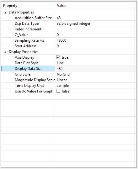

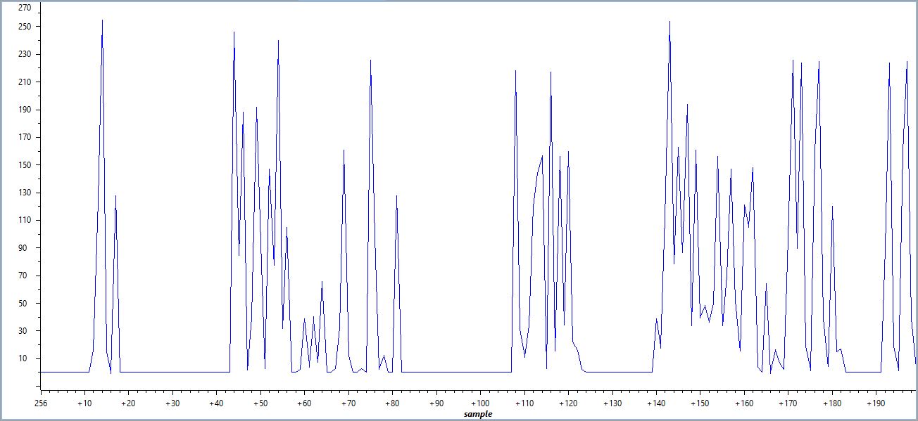

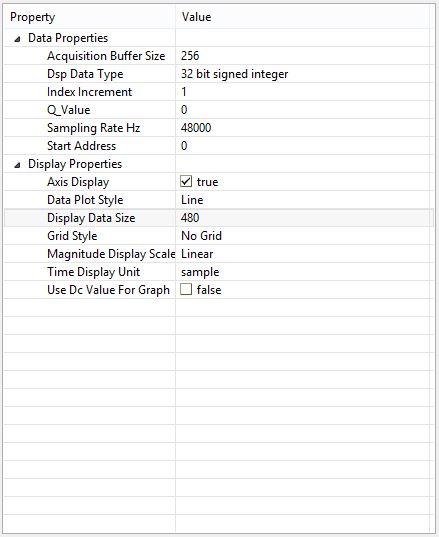

Output for both the code is coming the same. The output has been attached. Please help! Where am I going wrong? Because both the codes are running fine in MATLAB. Also I need help in the area of setting the parameters of graph tool.

  • Hi Gunturu
    I am not sure if the graph that you show is the result of the first code or the second.
    The first code is simple and I am not sure what is the problem with it.  (by the way, why do you need the pointers to be 16-bit?  it is faster if the pointers are the native size of the registers namely 32-bit)
    For the second code here is my suggestion -
    First define the theta_increment and theta as double precision and then increase the value of sampling frequency by a lot,  (I am not sure what is your sampling frequency)
    Do it, show the graph again and tell us what code generated the graph
    Ran

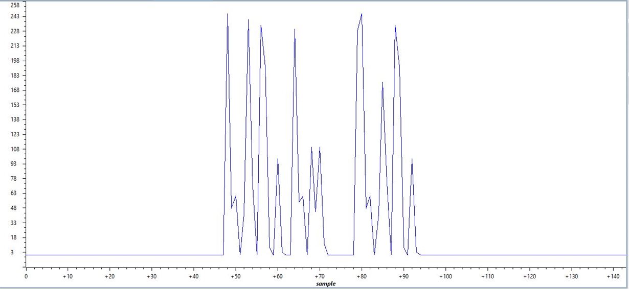

  • Hi Ran,
    Thank you for the reply. I have modified the code as per your suggestions.
    Here is the first one :

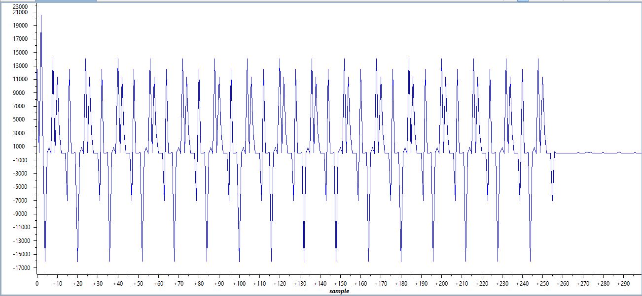

    Here is the second one :
    I increased the sampling frequency from 8GHz to 48GHz.

  • OK  Let's start with the table sin(x) and try to understand what is going on
    1. get the code out of the interrupt.  Make it a simple sin generation code with a long for loop
    2. Add a print out of the output vector  (run it for 1000 times)
    3. Look at the output print and verify that you see the values that are in the table one by one.
    4. If you see the correct values, the problem is with the interrupt function OR the graphic program that is used to display the results
    5. If you do not see the correct values,  re-compile the code with debug option and debug the code,  see how the index is changed from one run to another
    Report what you see
