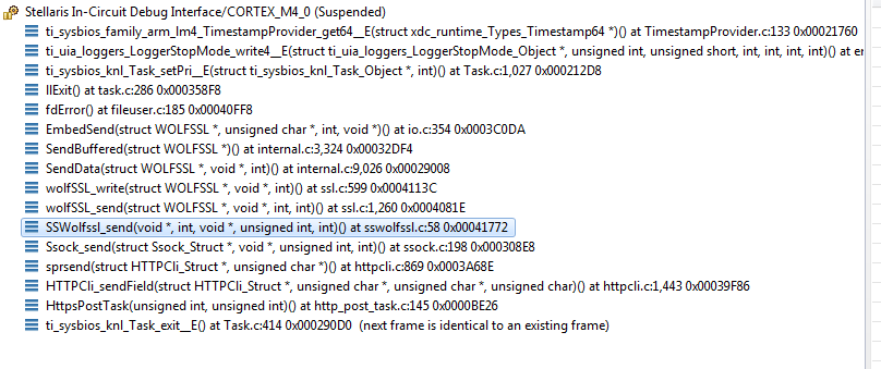

I see that my code is stuck on the 2nd of 4 "HTTPCli_sendField" calls that I make.
I am not sure if that is a consistent thing as this is the first time I have captured this with the debugger hooked up.

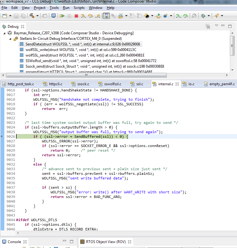

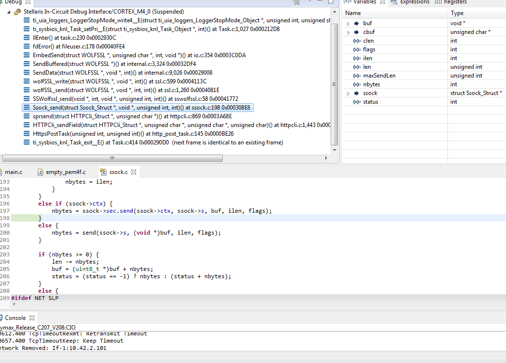

While stepping through the code, I can see that it's stuck in the while loop inside the "Ssock_send()" function in "C:\ti\tirtos_tivac_2_14_04_31\packages\ti\net\http\ssock.c"

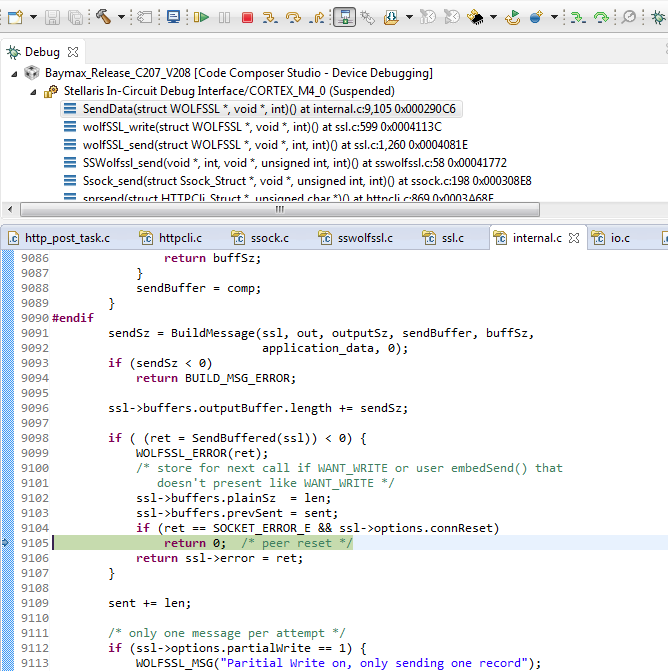

The while loop runs while (len > 0) but "nbytes = ssock->sec.send(ssock->ctx, ssock->s, buf, ilen, flags);" keeps returning 0.
This means that the next if condition is hit "if (nbytes >= 0)" but "len -= nbytes;" doesn't decrement since nbytes is 0.
I do not understand what would cause ssock->sec.send to keep returning 0 all the time. I even removed the ethernet connection and nothing changes.
I included some pictures of the stack trace (I think that's what it's called?) after pausing and resuming the device a few times.

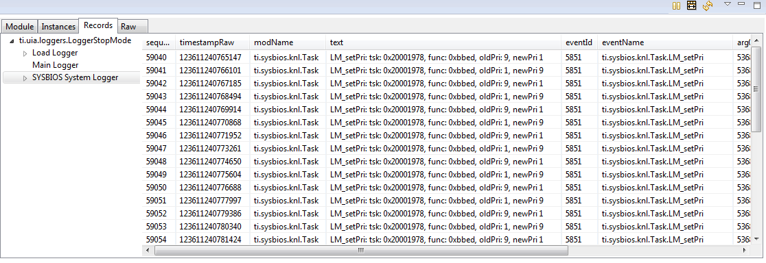

It looks like the NDK Stack Thread is toggling in priority between 1 (ROV shows 2 for some reason) and 9.
At least, that's what's reported in the SYSBIOS System Logger:
"LM_setPri: tsk: 0x20001978, func: 0xbbed, oldPri: 1, newPri 9"
"LM_setPri: tsk: 0x20001978, func: 0xbbed, oldPri: 9, newPri 1"
Deeper down in the WolfSSL code, I believe this error is being hit: "WOLFSSL_CBIO_ERR_WANT_WRITE"
But I do not know what that means, or why it would be happening.
EDIT: I think it's actually just returning WOLFSSL_CBIO_ERR_GENERAL or SOCKET_ERROR_E.

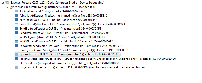

NDK_Send() calls fdint_lockfd() which hits this code in "tirtos_tivac_2_14_04_31\products\ndk_2_24_03_35\packages\ti\ndk\stack\fdt\file.c"
    /* Verify Socket and verify that it is open */
    if( !pfd ||
        (Type && pfd->Type != Type) ||
        ((pfd->Type != HTYPE_RAWETHSOCK) &&
#ifdef _INCLUDE_IPv6_CODE
        (pfd->Type != HTYPE_SOCK6) &&
#endif
        (pfd->Type != HTYPE_SOCK && pfd->Type != HTYPE_PIPE)
        ) || !pfd->OpenCount )
        pfdt->error = EBADF;
        return( SOCKET_ERROR );

    Removal of the ethernet is detected. This matches my previous finding that the NDK is still running, I can still ping the device...
    The NC_setLinkHook(LinkStateCallback) is still working.
    Basically, if I remove the Ethernet connection, I can remove and add an IP address using my callback function that I register using NC_setLinkHook.

  • It looks like the server is shutting down the connection (close notify alert) which is resulting in a return value of 0 from the send()/recv() calls. I am surprised that retrying send() after 0 was received did not result in a send failure ( < 0 return value). But anyways, this looks like a bug in Ssock that it does not handle the condition.
    I have filed a bug "NS-50 - Ssock should handle peer shutdown cases". But currently, I don't know of any new HTTP releases planned for TivaC. So, I would suggest the following options:
    • Is there a limit on how long the connection to the server can be opened? Can you make sure that you close the HTTP connection within that period and re-open the connection again?
    • Alternatively, in ti/net/http/sswolfssl.c, fix the return value check of wolfSSL_send() and wolfSSL_recv() to check for (ret <= 0) instead of (ret < 0)? After making this fix, you should rebuild the libraries by running "make -f tirtos.mak .clean-drivers .drivers" from the TI-RTOS directory.
    Hope this helps. Sorry about the inconvenience caused by the bug.

    2. NDK_Send is returning "SOCKET_ERROR". It is the WolfSSL code that takes that return value, and later returns a value of 0 send bytes. Is that what you were referring to by the "send()/recv() calls"?
      1. The reason this seems to happen is because this specific condition is hit: "if (ssl->error == SOCKET_ERROR_E && ssl->options.connReset)"
      2. The HTTPCli_Struct cli variable contains this: cli->ssock->ctx. The ctx is the WOLFSSL struct and it contains the error and options.connReset settings.
      3. Error is set during the NDK_Send, and I can only assume that at some point, I hit a peer reset or TCP reset and options.connReset were set as well.

  • S D said:
    Is it expected that the ROV should show all my tasks as priority 1?
    No, that is not expected. I have never seen such a behavior. ROV retrieves the actual data from the device when program is halted. So, it may be that something in your program is changing the priorities of your Tasks.

    • NDK_Send is returning "SOCKET_ERROR". It is the WolfSSL code that takes that return value, and later returns a value of 0 send bytes. Is that what you were referring to by the "send()/recv() calls"?
    Yes, send()/recv() refers to underlying WolfSSL send in this case.
    You are correct, the NDK_send() would return SOCKET_ERROR which is defined as -1 (ti/ndk/inc/bsd/socketndk.h).
    Let's try to trace this code flow. In wolfssl/src/io.c, the EmbedSend would make the call to underlying socket layer (NDK in this case). When it receives an error code, it would check errno. If the errno matches SOCKET_ECONNRESET it returns back WOLFSSL_CBIO_ERR_CONN_RST which if you trace it back would set  ssl->options.connReset to indicate peer closed and wolfSSL_send would return 0 (You can also check WolfSSL manual for the description of WolfSSL_send() return values).
    So, I still think you are hitting a peer connection closed condition.

  • S D said:
    I'm definitely going to try out the fix you suggested. I would like to try and figure out how to reproduce this issue so that I can prove this is the root cause.
    When you say a "peer connection closed condition", what does that mean at a protocol level? Does it mean a TCP RST was sent by the server?
    Is there an easy way to simulate this on a typical web server, maybe just shutting it down during a HTTP request?
    Since this is a protocol concept, I would recommend reading online about it as the online sources will explain in a detailed manner than I can do.
    S D said:
    Do you have any ideas as to what might be causing the tasks to all be set to priority 1?
    I only change the task priorities in a few very specific locations and I can't find anything that would set them all to 1.
    Is there any way this is a side effect of encountering an error like this where a particular task doesn't return? Or maybe a side effect of the debugger stopping and starting or anything like that?
    I don't know what may be causing this issue. I don't think any side effect should cause this behavior. I would recommend narrowing it down by putting multiple breakpoints in your programs and looking at ROV. Also, can you check ROV after you create a Task to make sure Task priority is set correctly.
