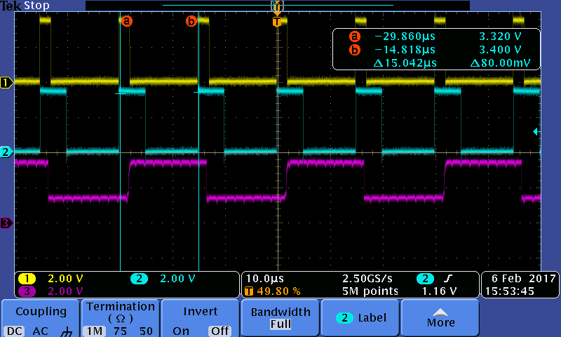

I setup the GPIO2_2 as an input and configured it to interrupt on a rising edge. I used the HWI that is setup by the GPIO driver as well tried this independently using an HWI I statically defined in the cfg file.
The DSP1 IRQ 56 was connected to Crossbar irq 25 (GPIO2). The external interrupt is configured to produce a rising edge every 15us. What I noticed is that it takes almost 500-700us for the control to jump in the ISR. However, if I enable both INT1 and INT2 for GPIO2 (keeping the crossbar config the same as I have mentioned able) I get a very good response.
As you can see the latency is roughly 2us. Blue trace = external interrupt   Maroon trace = GPIO I/O toggled in the ISR to measure response time.
Another observation. If I do not use the GPIO drivers inbuilt HWI and use my own, and clear IRQ status registers in the ISR manually, I noticed that clearing both IRQSTATUS_0 and IRQSTATUS_1 causes the response to become sluggish again.
Please can you let me know what I could be doing wrong or whether this is expected behavior.
Thanks very much.
Shaunak

    Can you explain what Processor SDK RTOS version was used for this experiment? Latest 3.2? The GPIO interrupt used is defined in our code pdk_am57xx_1_0_5\packages\ti\drv\gpio\soc\am572x\GPIO_soc.c. The structure only uses one interrupt per GPIO.
    We need some test to benchmark the performance.
    Regards, Eric
  • Hi Eric,
    I am using 'processor_sdk_rtos_am57xx_3_01_00_06' and 'pdk_am57xx_1_0_4'. I traced the GPIO driver code and figured out how the HWI was been created but the question is why I need to enable both the INT0 and the INT1 interrupt for the control to vector into the ISR in a timely fashion. If I just enable INT0 or INT1 the response is sluggish. Do you have any explanation as to why this could be happening?
    Shaunak

    I measured the point when the GPIO interrupt is triggered, to the point callback function is entered. The time is about 1300 cycles based on 600MHz DSP clock, or 2.2us .
    The measure used the DSP cycle counter TSCL. Note the callback function is called at the bottom of GPIO_v1_hwiFxn(). So the time entering into HWI would be shorter than this.
    I don't see the sluggish GPIO interrupt response with only one interrupt line enabled.
    Regards, Eric

  • Hi Eric,
    No worries on that!
    The situation is such:
    1. When I manually trigger the GPIO INT0 interrupt:
    a. I configure only the GPIO INT0 interrupt and the crossbar accordingly (again only for INT0)
    b. The GPIO pin has been configured to generate an event on a rising edge
    This results in a great response when the interrupt is manually triggered
    2. When I use an FPGA to generate a pulse @ 15us
    This results in sluggish response. But now if I enable INT1 too, leaving the crossbar as is, the response is similar to what I get when I trigger the interrupt manually.
    Please let me know if you need more info.
    Shaunak
