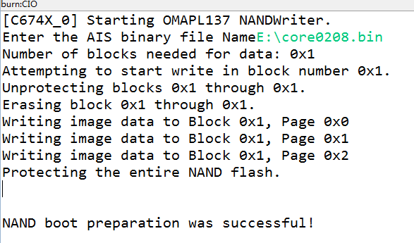

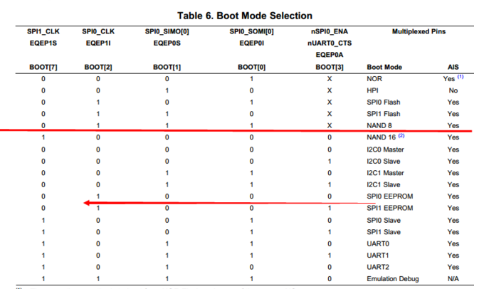

I have made my own C6747 board booting from nand flash, i config the mode by pull up/down resistor and the value is 1k, but the BOOTCFG register is 0x0004, it's spi0 eeprom mode,and the board can't start from nand flash , I have measure the pin by multimeter, it's accord with nand flash mode.
