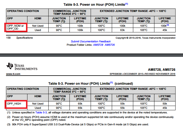

I have question how to use OPP for AM5728.
Q1: Can I use VDD_MPU as OPP_NOM and VDD_DSP as OPP_HIGH?
Q2: If Q1 is possible, which one is applied in Table 5-3 POH?

    Have a look at Section 5.5 Operating Performance Points of AM5728 Data Manual. It describes the OPP usage in the device. Table 5-7. Voltage Domains Operating Performance Points shows the voltages required for achieving each of the device OPPs. Take special attention to Note (5) bellow the table:
    (5) The AVS voltages are device-dependent, voltage domain-dependent, and OPP-dependent. They must be read from the
    STD_FUSE_OPP. For information about STD_FUSE_OPP Registers address, please refer to Control Module Section of the TRM. The
    power supply should be adjustable over the following ranges for each required OPP:
    – OPP_NOM for MPU: 0.85 V – 1.15 V
    – OPP_NOM for CORE and Others: 0.85 V - 1.15 V
    – OPP_OD: 0.885 V - 1.15 V
    – OPP_HIGH: 0.95 V - 1.25 V
    The AVS voltages will be within the above specified ranges.
    AVS is required for vdd_core, vdd_mpu, vdd_ivahd, vdd_dspeve and vdd_gpu for all available OPPs.

    I understood that I can use different OPP for each voltage domain.
    If any domain is using OPP_HIGH, Should POH apply the condition of OPP_HIGH? So, I would like to clarify the above Q2.
    Yes, my understanding is the same. If OPP = OPP_HIGH, then POH=65k.
