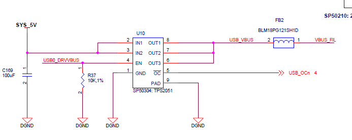

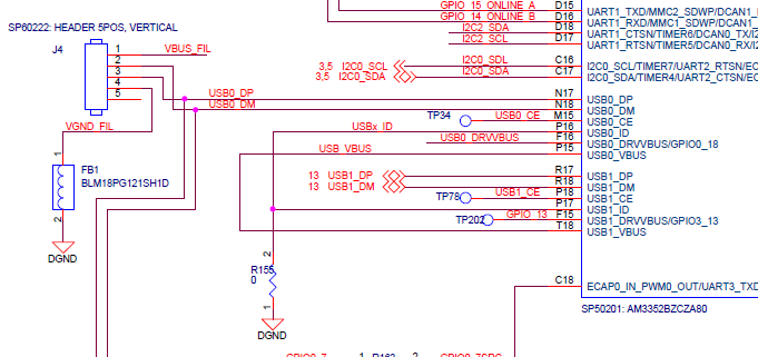

I have devices hooked up to USB0 and USB1 on a custom design. I am able to boot into linux, and I make USB1 a host, which is connected to a USB to Eth LAN9500A chip. The processor, however, is not able to see anything on USB1. I can show you snippets of the schematic where there are issues and maybe you can help out?
  • As a side note, I am able to fully use the device on USB0. In the Uboot we make USB0 a host and USB1 a peripheral. I load code from USB0 into the eMMC in order to boot into linux. Once in linux, we are able to make USB1 a host as well, however, still not able to see the device on USB1.
    You need a separate VBUS switch for USB1, which should be controlled by USB1_DRVVBUS.
  • That makes sense for separate functionality. However, I am just wondering if we are able to see USB0, and that enable on USB0 technically drives the power for USB0 and USB1, why exactly will it still not see USB1 in this situation as long as USB0 is being enabled?
  • Michael,
    Ideally the design requires to separate the VBUS lines of USB0 and USB1. In your design, If USB0 has already enabled VBUS power switch, then later when USB1 wants to transition to host mode it will fail, due to VBUS already has >= 4.4v voltage.

    - You can decouple am335x usb0 and usb1 by separating USB0_VBUS and USB1_VBUS pins (I never saw am335x MUSB is designed this way before...). Keep USB0_VBUS with the current power switch, but directly connect USB1_VBUS pin to a 5V power rail. You still need the two patches I mentioned previously, and set USB1 dr_mode="host" in dts.
