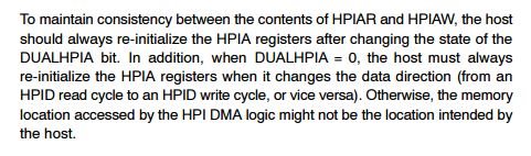

Part Number: TMS320VC5502
Tool/software: Starterware
Hi
I am using HPI interface to write to DSP TMS320VC5502. when i read followed by write, the data is getting written in OLD address (read address). if i verify the HPIAW register using JTAG i can see that proper address was written to it But HPID data is loaded in wrong address.
