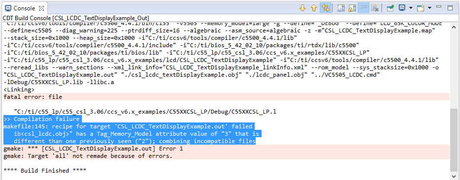

CCS/BOOST5545ULP: CCS won't compile for boosterpack software demos
Part Number: BOOST5545ULP
I am using the TI C5545 BoosterPack for a project. To better understand and learn how to code this boosterpack, I am attempting to build and run the sample projects for the booster pack. However, I keep running into the error posted above in the photo. Is this a common issue or a quick fix?
Soham
  • Soham,
    That error arises because of a mis-match in the memory model of the library. You can correct this by going to:
    Properties>Build>C5500 Compiler>Processor Options> Specify memory model to huge.
    Properties>Build>C5500 Compiler>Processor Options>Advanced Options>Run Time Model Options>ptrdiff_size to 32
    Then rebuild the library. Its strange that you are getting this error by default because the examples should be for large memory model.
