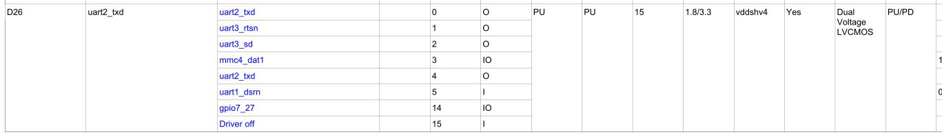

My customer is using the AM5728, however, we found that in the latest datasheet,the PIN D26, which named uart2_txd, has two modes of working as uart2_txd, mode 0 and mode 4. Is this true? or is there any typo?

Steven,
The DM is correct. This pin has the same function on both selection 0 and 4. There are other pins in the table like this too. I re-verified it in the design documentation that the table is valid. Either selection will provide the same functionality.
