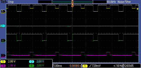

I am trying to integrate a 5-wire touch screen with my custom board based on BBB. The processor is AM3354BZCZ60.  I am using the ti-processor-sdk-linux-am335x-evm-03.01.00.06 SDK. The Linux kernel is 4.4.19-gdb0b54cdad. I have added the following to the device tree (am335x-bonrblack.dts):
/* Set up for 5-wire touch screen */
&tscadc {
        status = "okay";
        tsc {
                ti,wires = <5>;
                ti,x-plate-resistance = <129>;  /* measured between pins UL & UR, and between pins LL & LR. */
                ti,coordinate-readouts = <5>;
                ti,wire-config = <0x00 0x11 0x22 0x33>;
        ti,charge-delay = <0x400>;
        /*adc {
                ti,adc-channels = <5 6 7>;
See whole DT attached:

The touch screen seems to be working along the x-axis, but not long the y-axis.
The output from the evtest utility shows ABS_X and ABS_Y to have about the same value regardless of were the screen is touched.

In the attached file, I have indicated in brackets [ ] where the screen was being touched. "..." indicates where data was removed for clarity.
In the following image Chanel-1 is AIN0 (UL), Chanel-2 is AIN1 (UR), Chanel-4 is AIN2 (LL), and Chanel-3 is AIN3 (LR):
p { margin-bottom: 0.1in; line-height: 120%; }a:link { }
I think it looks like the 2-ohm pull-up/pull-down resistors are not switching correctly. What is the expected sequence?

  • Hi Ron,
    As you describe the connection between the tscadc & LCD:
    I think you need to modify the wire-config parameter in your dts. See the description of this parameter in the Documentation/devicetree/bindings/input/touchscreen/ti-tsc-adc.txt file:
    ti,wire-config: Different boards could have a different order for

  • Thank you for your reply.
    I believe that my wire-config parameters are correct.
    0x00 → 1st 4-bits=0 → AIN0 → 2nd 4-bits=0 → XP → upper left corner (UL) → Channel-1 on o'scope.
    0x11 → 1st 4-bits=1 → AIN1 → 2nd 4-bits=1 → XN → upper right corner (UR) → Channel-2 on o'scope.
    0x22 → 1st 4-bits=2 → AIN2 → 2nd 4-bits=2 → YP → lower left corner (LL) → Channel-4 on o'scope.
    0x33 → 1st 4-bits=3 → AIN3 → 2nd 4-bits=3 → YN → lower right corner (LR) → Channel-3 on o'scope.
    The line “In the following image Chanel-1 is AIN0 (UL), Chanel-2 is AIN1 (UR), Chanel-4 is AIN2 (LL), and Chanel-3 is AIN3 (LR):” dose not describe the connection between the tscadc and the LCD. Rather, it maps the signals shown on the oscilloscope image to the AIN signals. Am I misunderstanding the meaning of XP, XN, YP, & YN? I thing that the wiring is correct. If I monitor AIN4 (wiper) and press on the UL corner of the LCD, I see the pattern shown in the posted o'scope image for Channel-1. Similarly, pressing on the UR, LL, and LR corners gives the patterns for Channels-2, 4, and 3 respectively.
    The LCD clock frequency is 71.1 MHz. This is recommended by the manufacturer (Densitron). Densirton specifies a range from 68.9 to 73.4 MHz. I fear that going to far out of that range will be detrimental to the image quality, but I will give it a try.
    Update: I have tried LCD clock frequencies from 40 to 80 MHz with no change in the performance of the touch screen.
  • p { margin-bottom: 0.1in; line-height: 120%; }
    I tried different wire-config parameters expecting to see the signals at AIN0 thru AIN3 shift, but they did not. Then I ran evtest for different wire-config parameters. Again there was no change in the output from evtest. These are the parameters I tried:
    ti,wire-config = <0x10 0x01 0x22 0x33>;
    ti,wire-config = <0x01 0x10 0x22 0x33>;
    ti,wire-config = <0x20 0x11 0x02 0x33>;
    ti,wire-config = <0x10 0x21 0x32 0x03>;
    ti,wire-config = <0x01 0x12 0x23 0x30>;
    Then I tried changing wiring to the touchscreen. By changing the wiring I could change which corners were relatively high and which corners were relatively low, but regardless of wiring or where the screen is touch the ABS_X and ABS_Y values reported by evtest are the same.
    Do I not understand what ABS_X and ABS_Y are? I think that when touching one corner they should both be low, in another corner both high, and in the other corners ABS_X and ABS_Y should be different. Is this correct?
    Could the driver be corrupt? I think that the driver is “.../linux.../drivers/input/touchscreen/ti_am335x_tsc.c”. Is this correct? Can I get a fresh copy without downloading the whole SDK?
    Any ideas?
