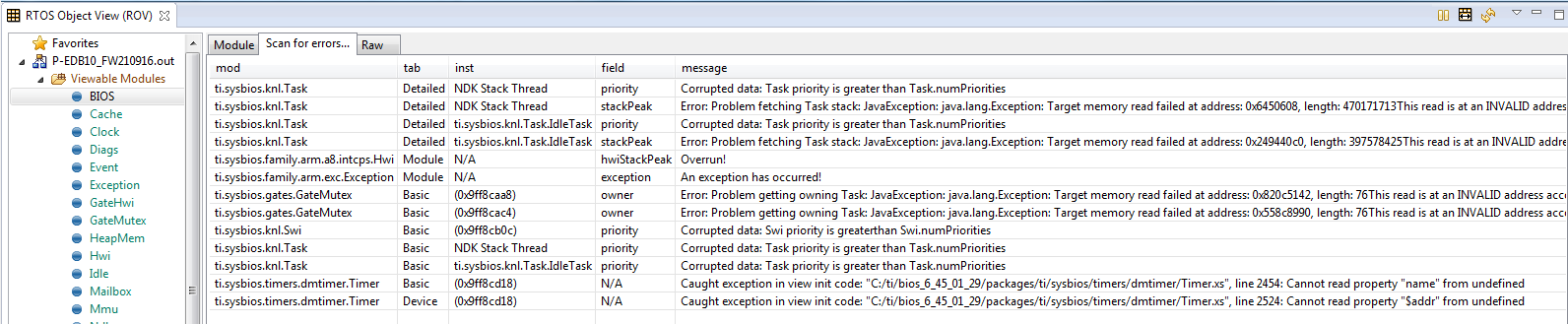

we are working with AM3356 processors on in-house developed boards based on AM335x ICE v2 design. These boards have already been in use for a few weeks in a pilot plant. They are placed in line topology and every Board hast its own static IP-address. We use the ICSS-Switch functionality and the boards receive data over Ethernet from a PC. So far everything went well. Last week we had to replace two of the seven boards in our pilot plant. The replaced boards are crashing while the initialization phase. In fact that these boards worked correctly for a few weeks, we assume a hardware problem. With the XDS100v2 debug probe we tried to localize the errors. The “Scan for Errors-Tab” in the ROV-Tool shows the following errors:
Do you have any assumptions why our boards do not work correctly anymore or with which actions we can localize the problems?

  • By the way, have you run a memory test on the failed boards? Can you post more information about the memory you use, and whether it has been configured as described here:

    we use am335x_sysbios_ind_sdk_01.01.01.01 together with SYSBIOS 6.45.1.29 and NDK 2.25.0.09. I am able to flash binaries into the SPI flash with the XDS100v2 debug probe and the CCS based isdk_spi_flasher without any errors. Connecting the debug probe to one of the defective boards, the program counter stops always at the same address (0x80028A60). So, I assume that the firmware is executed until a certain point.

  • Hi Luca, are you running your own application or it is any of the examples from our ISDK?
    Also, a couple of ideas, you can check your memory map and see if you can find out which function/module is running at address 0x80028A60. Additionally, you can open Disassembly view and see, when program hang, if there is any recognizable function. These could give you and idea on where things fail..
