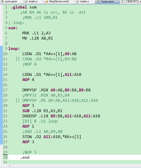

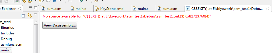

I tried to call the assembly file in C, Success without SYS/BIOS, but It's not successful in SYS/BIOS,
The following error occurred while I was running to the assembly function called.
This is assembly :
thank you!
    Verify to be compliant to the EABI as per TI SPRAB89A C6000 Embedded Application Binary Interface.
    For instance, You have to preserve A10-A15, B10-B15, A2 (see §3.2). Also it seems to me that your routine miss the return statement"B B3" (followed by a NOP 5).
    Note that the behaviour can depend on the caller: if it does not use A11:A10, you routine could seem to work fine.
    I also suggest to You tu use .asmfunc/.endasmfunc to mark the begin and end of assembler function (nicer for the debugger and mix asm/C).

    thank you very much for your answer and suggestion.
    I have run successfully.
    best Regards.
    Attach my successful assembly code
