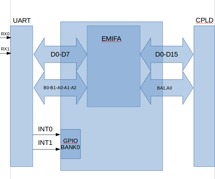

The DSP is connected to a 5 MegaBaud Dual Channel Uart ( 64 bytes FIFO, programmable trigger levels, multiple status/config registers )
Via Emifa ( 48Mhz speed, CS4 memory space, Asynchronous, 8 bits mode, and timings according to the datasheet of the uart chip)
and also, 2 interrupt lines connected to GPIO Bank 0 (1 and 2 ).

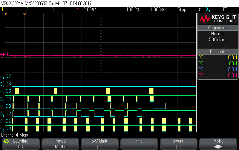

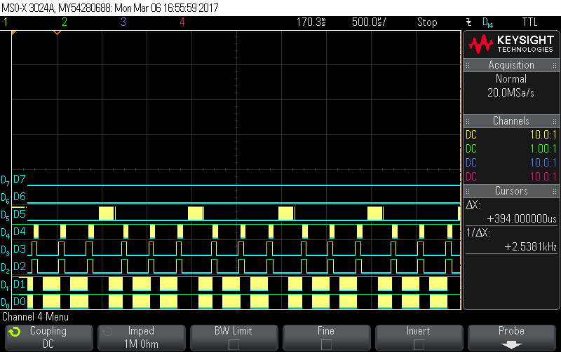

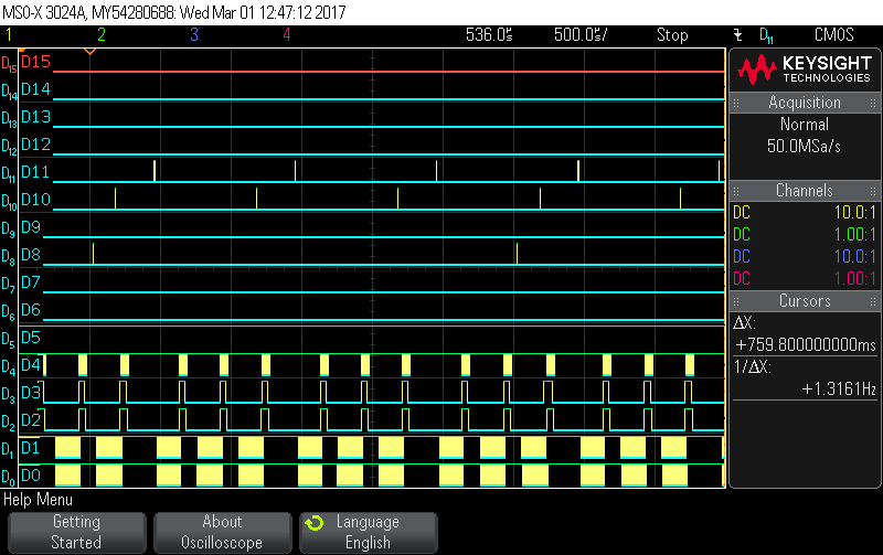

Result :
after each 64 byte chunk, the interrupt line goes high and then CS4 starts toggling which illustrates the ISR handling and the EDMA3 read. They both work fine and gives us the expected results.
D0 : Uart Channel 0 incoming data
D1 : Uart Channel 1 incoming data
D2 : Uart Channel 0 Interrupt Line
D3 : Uart Channel 1 Interrupt Line
D4 : Emifa CS4
The Problem :

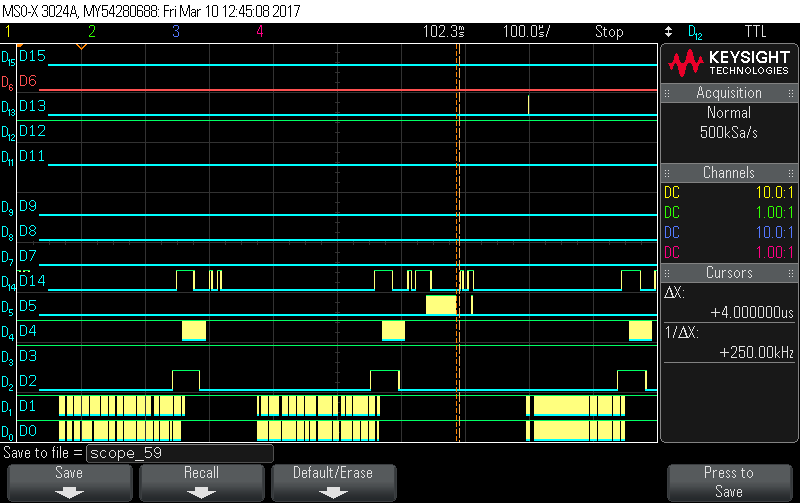

It occured when we started feeding the buffers to the algorithm, whereas, we buffer 2080 samples into a "PingBuffer" (which has the size of 1MB) and we pass it to the algorithm which is running in the main loop. We start filling in the "Pong buffer". Everything keeps working fine until a certain point in time, the ISR gets delayed abnormally and we lose synchronization and therefore, we dont meet our deadline.
The following snapshot illustrates this behaviour.
