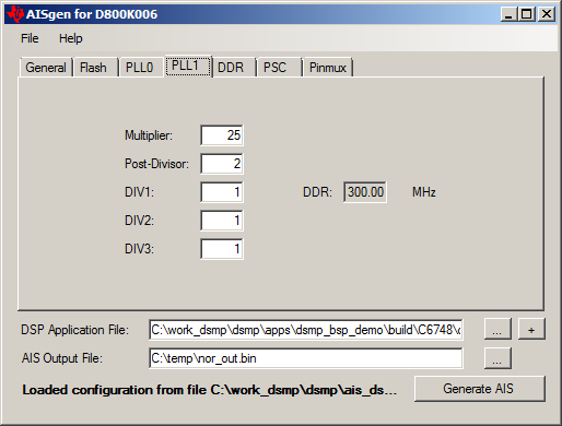

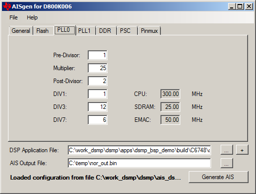

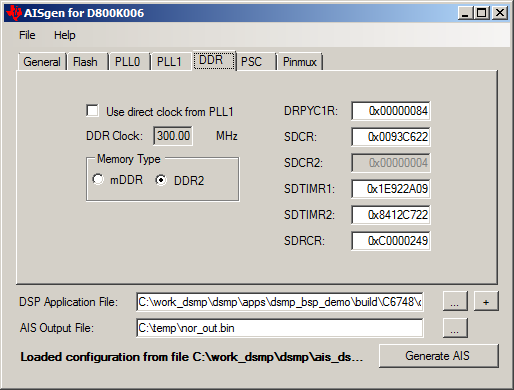

The AISgen configuration is:

    2) The value at address 0xB0000014 (Timer 2) is different from the value I set in the AISgem (0x8412C722 and 0x0412C722 correspondingly)
    3) The value of SDRCR is different too (Read value from register: 0x00000249, originally set value: 0xC0000249)
    Uri
    I believe this should be a don't care SDTIMR2 bit 31 is reserved as per the documentation, so you should see a 0x0412C722 even though you tried to write a 1 to bit 31?[
    Can you try a value of 0x249 , and see if that works?

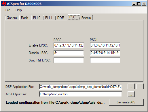

  • Also even though I think it should be a don't care, please see if not enabling DDR2 via PSC in the config file explicitly helps. Since you are using AISGEN to configure the DDR2, I don't think you need to have that additionally done in the PSC tab.
    Mukul
  • Mukul, Jeff and all,
    Steps I have taken -
    1) Remove PSC #6 (DDR) from the PSC tab - no change
    2) Change the SDRCRto 0x249 - no change
    The ROMID is "d800k004" (re-checked)
    The AISgen configuration file is attached inline below.
    Uri

    I have now fixed my issue, it was an incorrect register.
    for reference, my DDR register settings are;
    DRPYC1R: 0x000000C4
    SDCR: 0x08134632
    SDTIMR1: 0x184929C8
    SDTIMR2: 0x184929C8
    SDRCR: 0x00000406
    This is on a custom board running the c6748 with DDR2

      NOTE:  If you configure the DDR2, don't need to have enabling DDR2 via PSC.
    So, I'll try to use the feedback link and ask to add the NOTE to SPRAAT2C.
    j-breeze
  • can you  tell me how to resovle the problem?
  • zhaoshuai-san,
    Just  not need to have enabling DDR2 via PSC in AISgen PSC tab when you use AISgen to configure the DDR2.
    j-breeze

  • ; General settings that can be overwritten in the host code
    ; that calls the AISGen library.
    [General]
    ; Can be 8 or 16 - used in emifa
    busWidth=16
    ; SPIMASTER,I2CMASTER,EMIFA,NAND,EMAC,UART,PCI,HPI,USB,MMC_SD,VLYNQ,RAW0
    BootMode=EMIFA
    ; 8,16,24 - used for SPI,I2C
    ;AddrWidth=8
    ; NO_CRC,SECTION_CRC,SINGLE_CRC
    crcCheckType=NO_CRC
    ; This section allows setting the PLL0 system clock with a
    ; specified multiplier and divider as shown. The clock source
    ; can also be chosen for internal or external.
    ;           |------24|------16|-------8|-------0|
    ; PLL0CFG0: | CLKMODE| PLLM   | PREDIV | POSTDIV|
    ; PLL0CFG1: | RSVD   | PLLDIV1| PLLDIV3| PLLDIV7|
    ; PLL0CFG0: | 0      |   25   |   1    |    2   |
    ; PLL0CFG1: | 0      |   1    |   12   |   6    |
    ;[PLL0CONFIG]
    ;PLL0CFG0 = 0x00180001
    ;PLL0CFG1 = 0x00000205
    [PLL0CONFIG]
    ;PLL0CFG0 = 0x00180101	;was
    PLL0CFG1 = 0x00000B05
    ;PERIPHCLKCFG = 0x00010064
    ; This section lets us configure the peripheral interface
    ; of the current booting peripheral (I2C, SPI, or UART).
    ; Use with caution. The format of the PERIPHCLKCFG field
    ; is as follows:
    ; SPI:        |------24|------16|-------8|-------0|
    ;             |           RSVD           |PRESCALE|
    ; I2C:        |------24|------16|-------8|-------0|
    ;             |  RSVD  |PRESCALE|  CLKL  |  CLKH  |
    ; UART:       |------24|------16|-------8|-------0|
    ;             | RSVD   |  OSR   |  DLH   |  DLL   |
    ;[PERIPHCLKCFG]
    ;PERIPHCLKCFG = 0x00000000
    ; This section can be used to configure the async chip selects
    ; of the EMIFA (CS2-CS5).  The fields required to do this
    ; are given below.
    ; A1CR:     |                A1CR               |
    ; A2CR:     |                A2CR               |
    ; A3CR:     |                A3CR               |
    ; A4CR:     |                A4CR               |
    ; NANDFCR:  |              NANDFCR              |
    ;[EMIF25ASYNC]
    ;A1CR = 0x00000000
    A2CR = 0x3FFFFFFD
    ;A3CR = 0x00000000
    ;A4CR = 0x00000000
    ;NANDFCR = 0x00000000
    ; This section allows setting up the PLL1. Usually this will
    ; take place as part of the EMIF3a DDR setup. The format of
    ; the input args is as follows:
    ; PLL1CFG0: |    PLLM| POSTDIV| PLLDIV1| PLLDIV2|
    ; PLL1CFG1: |           RSVD           | PLLDIV3|
    ; PLL1CFG0: |    25  |  2     | 1      | 1      |
    ; PLL1CFG1: |           RSVD           | 1      |
    ;[PLL1CONFIG]
    [PLL1CONFIG]
    PLL1CFG0 = 0x18010001
    PLL1CFG1 = 0x00000002
    ;DSMP DDR2
    [DSP_EMIF3DDR_PATCHFXN]
    DDRPHYC1R = 0x00000084
    SDCR = 0x0093c622
    SDTIMR = 0x1E922A09
    SDTIMR2 = 0x8412C722
    SDRCR = 0xC0000249
    CLK2XSRC = 0x00000000

        DRPYC1R = 0x84; // EXT_STRBEN = External strobe. RL = (CAS latency + 1)
        /* 2.13.2    [7] */
            /* 2.13.1    [7 2] */
            // Program the SDRAM configuration register (SDCR) with BOOTUNLOCK bit set to 1 (unlocked).
            EMIF3A_SDCR |= SDCR2_BOOTUNLOCK;
            EMIF3A_SDCR |= SDCR2_TIMUNLOCK;
            /* 2.13.1    [7 3] */
            EMIF3A_SDCR = 0x0093C622; // BOOTUNLOCK locked
            EMIF3A_SDCR &= ~(SDCR2_BOOTUNLOCK); // BOOTUNLOCK locked
            /* 2.13.1    [7 4] */
            // SDCR2
            EMIF3A_SDCR2   = 0x00000004; // 8K rows
            /* 2.13.1    [7 5] */
            // Timers
            EMIF3A_SDTIMR1 = 0x1E922A09;
            EMIF3A_SDTIMR2 = 0x8412C722;
            /* 2.13.1    [7 6] */
            // TIMUNLOCK locked
            EMIF3A_SDCR &= ~(SDCR2_TIMUNLOCK);
            /* 2.13.1    [7 7] */
            // Refresh rate
            EMIF3A_SDRCR = 0x00000249 | (0x1 << 30) | (0x1 << 31); /* The two MSB bits are per correction from the forum */
        /* 2.13.2    [5] */
        // PSC reset
        PSC1_LPSC_SyncReset(PD0, LPSC_DDR);
        PSC1_LPSC_enable(PD0, LPSC_DDR);

    Regarding the utility, I'm using HexAIS_OMAP-L138.exe with patch, provided by TI, to overcome the DDR initialization problem with the AISGen  v006.
    The problem might have been fixed with newer version (such as v008) but I have never checked it. If you like to have the patched HexAIS_OMAP-L138.exe, let me know (+ email address), it's not allowed to attached binaries to this post.
    The HexAIS_OMAP-L138.exe configuration file (renamed for disallowed .ini) is attached
    Uri
