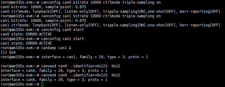

my project have two can,they all can work in 20k,50k bit rate,but it can not work in 10K bit rate .can anyone give me a help
    I don't see any errors in this picture you have posted. Can you explain in more details?
  • in my test,CAN0L---CAN1L,CAN0H---CAN1H.
    in 10k bit rate ,test,can0 send data,but candump can not dump any data.
    int 10001 bit rate or larger than 10k,can0 send data,candump can dump the data which can0 send.

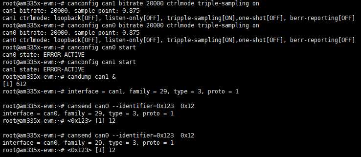

    see this test,test 20k bit rate,candump the right data.
    see this test,try 10k bit rate.candump dump no data.

  • hi :
        we use the custom board reference to the design of the AM335X EVM.
        yes,i test can0 connect to can1.but our Customer use CAN0 connect to PC with 10 bit rate,and test failed.CAN0 can not receive anydata,and when can0 send data,the PC can not receive any data too.
        I test 10k ,failed. 20k ok,50k ok.500k ok,800k ok,900k faild,1M faild.
    when can1 can not receive the message,i see the can0 config.
    I command "canconfig can0"
    the message is
    this is 10k test error
