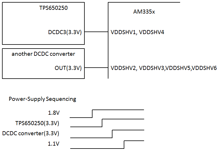

My customer is planning to use TPS650250 and one another DCDC for Powering the AM335x.
The connection and Power up sequence is like follows.

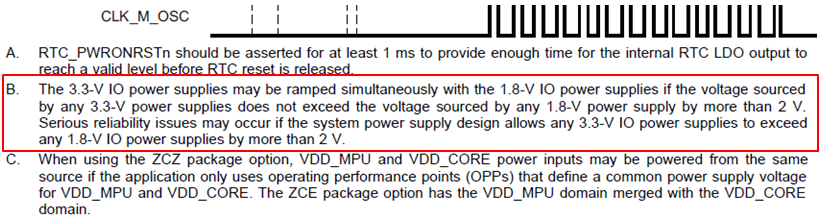

I'm worried about this statement of AM335x data sheet(SPRS717J) P101.
the (VDDSHV1, VDDSHV4) and (VDDSHV2, VDDSHV3,VDDSHV5,VDDSHV6) are different more than 2V  in my customer's Power up sequence.
Is this sequence no problem ?
