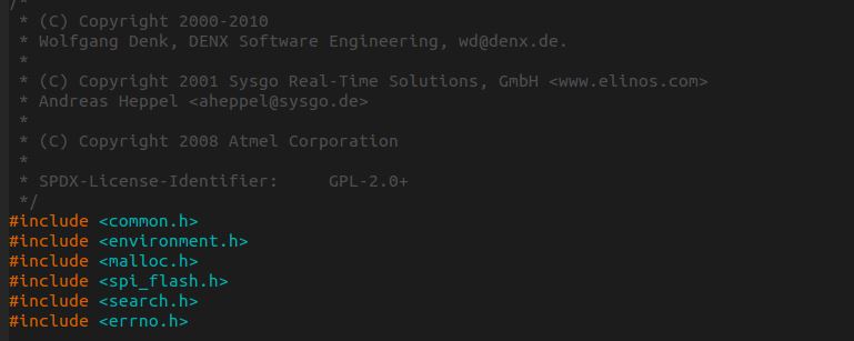

Linux/AM4378: port u-boot to my board,errors were occur.
Part Number: AM4378
Tool/software: Linux
include/asm/arch/hardware_am43xx.h:23:0: note: this is the location of the previous definition
drivers/usb/phy/omap_usb_phy.c: In function ‘usb_phy_power’:
drivers/usb/phy/omap_usb_phy.c:226:2: warning: "/*" within comment [-Wcomment]
drivers/usb/phy/omap_usb_phy.c:229:3: warning: "/*" within comment [-Wcomment]
LD spl/drivers/usb/phy/built-in.o
LD spl/arch/arm/cpu/built-in.o
LDS spl/u-boot-spl.lds
LD spl/u-boot-spl
common/built-in.o: In function `env_relocate_spec':
/home/yangyongsheng/Public/ti-u-boot/common/env_sf.c:152: undefined reference to `spi_flash_probe'
/home/yangyongsheng/Public/ti-u-boot/common/env_sf.c:213: undefined reference to `spi_flash_free'
make[1]: *** [spl/u-boot-spl] Error 1
make: *** [spl/u-boot-spl] Error 2
but i definede spi_flash_probe and spi_flash_free in drivers/mtd/spi/sf_probe.c
and the file has complied:
7 struct spi_flash *spi_flash_probe(unsigned int bus, unsigned int cs,
368                 unsigned int max_hz, unsigned int spi_mode)
369 {
370         struct spi_slave *spi;
371
372         spi = spi_setup_slave(bus, cs, max_hz, spi_mode);
373         return spi_flash_probe_slave(spi);
374 }
87 void spi_flash_free(struct spi_flash *flash)
388 {
389         spi_free_slave(flash->spi);
390         free(flash);
391 }
and sf_probe.c  head file is spi_flash.h,in the file i can see
126                 unsigned int max_hz, unsigned int spi_mode);
void spi_flash_free(struct spi_flash *flash);
in env_sf.c,i can see
so why these errors occur??
