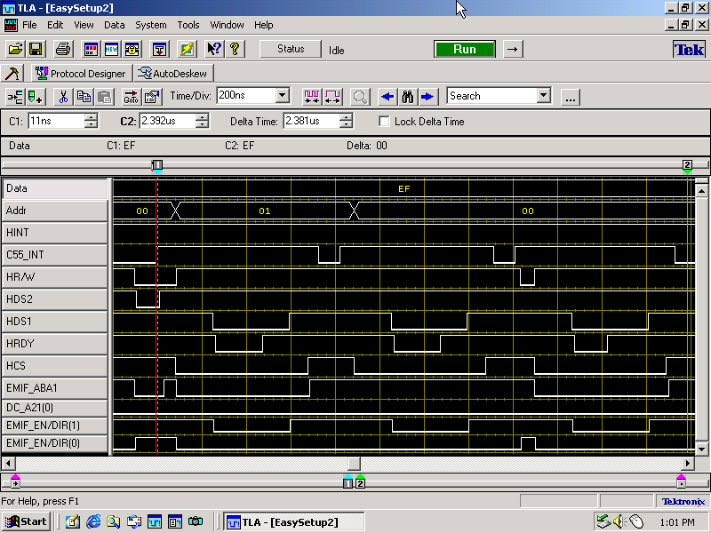

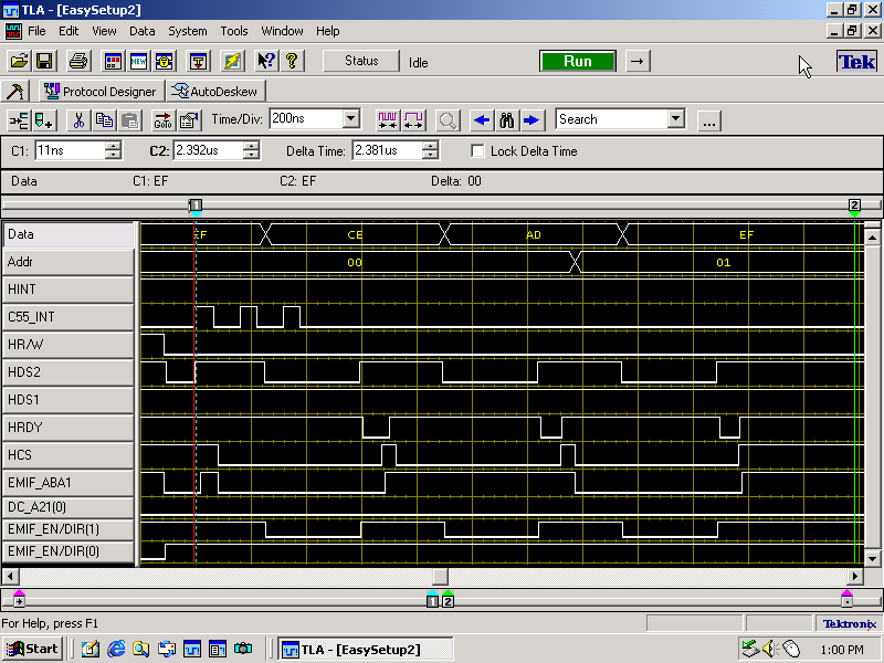

    Okay, below I have HPID write/read logical analyzer screengrabs.  Note that only the 8 LSBs of the data and address buses are probed.  For the write, I write to 3 consecutive addresses the values 0xFACE, 0xDEAD, 0xBEEF.  For the read, I try to read these 3 consecutive addresses.  Note that during the read, the only values on the data bus are that which were written last - i.e. 0xEF (this happens when I've enabled the EHPI data bus holders; otherwise, I would read 0xFF if my logic analyzer probes are connected to the bus or 0x0 if not).  All control signals look good, and the HRDY signal is strobing as if the data is being properly extracted from the buses to memory.  Anyone see anything that might not look right in these signals?
    Write:
    Read:
  • Hi Derek,
    Are you meeting the 4ns setup and 4ns hold time specs E13, E14?  It is hard to tell at 200ns/period.
    I agree that the HRDY response looks reasonable on writes.    For Reads, based on my C6x experience,  I might have expected the 2nd and 3rd Read HRDY to be much shorter/faster/sooner due to fetch ahead, if HPID++ mode were correctly accessed.
    What is C55_INT signal?    What are EMIF_ABA1, and EMIF_EN/DIR[1:0] signals connected to on the HPI side?
      --Joel Graber

  • OK,    HPID++ does not apply for you.    I'm reading from spra741a.pdf.
    Your non-multiplexed mode means HMODE is driven high, and you are providing HAddr on its own bus (Addr in the waveforms).
    HCNTL[0]   needs to be 0 for HPIC access and 1 for HPID access, is it shown in your waveform?
    You mention doing half-word accesses, but the C55 is a 16 bit machine, so all accesses are half-word=16bits anyway.  So you shouldnt have to worry about the high-half-lowhalf ordering of a 32bit word here if you are only accessing 16bit memory internal to the C55,  which is a good place to start.
    What address are you using in the C55 global memory map?  Section 3.2.3 and figure 3.4 of tms320vc5510a.pdf shows that address 0 is not accessible to EHPI.  If addressing CE0 space, then the EMIF registers for that space need to be setup first.
    --Joel Graber
  • On the DSK5510, HMODE is held high through external logic, and I have verified that with a scope.  I am providing HA on its own bus, as you noted.  In the logic analyzer screengrabs, I have only shown the 8 LSBs of the address and data buses.
    HCNTL[0] is low for HPIC access, but for these grabs, it was 1 since I was trying to do data access.  I have this wired to a switch on my board and have verified its level.  And yes, regarding endian-ness, I do not have to worry about this, as the C5510 uses 16-bit bytes.
    In the C5510 memory, I am trying to access word address 0x18000 (byte address 0x30000) in the middle of SARAM.  From my C6455, I am using CE4 space for EMIF, and I am fairly certain all of my configuration for C6455 EMIF has been done correctly.
    As far as HPI goes, I have only been able to write to HPIC (though not read from it), and I have not successfully read or written HPID.  I'm stumped because it would appear that all the various control signals seem correct (I have even verified their integrity with a scope - no ringing or overshoot, good levels).  Thanks again for your continued help!
  • Summary:  The HRDY activity suggests that the proper internal activity is happening, but you have no other evidence of that, such as any output from HData bus.
    Here are some additional debug brainstorms to try,  no particular order, numbered only for future reference.
    1. Some problem with driving the HD bus as output?:   Use CCS to write to CPU side of HPIC to set and release HINT, to show that it can be toggled.  This should be sufficient test that TRST and EMU1 are not set to "OFF" mode functionality.   Is there any other reason why all pins, or Hdata pins would have their outputs disabled?
    2  Is the internal activity really happening?    Try write with HPI to SARAM, and then use CCS monitor to show internal contents of that address to see if it changed.   Also try the reverse,  use CCS to write a large range of nearby addresses with data=address.  Then use HPI read to see if you get any change on HData bus.
    3. Try with/without HPE internal pullup/pulldown enable/disable bit in the SYSR?
    4. Can HData write and read to HPIA?  Change into muxed-mode and do write and readback operations on HPIA register.  No memory accesses are involved, HRDY typically does not toggle.
    --joel
