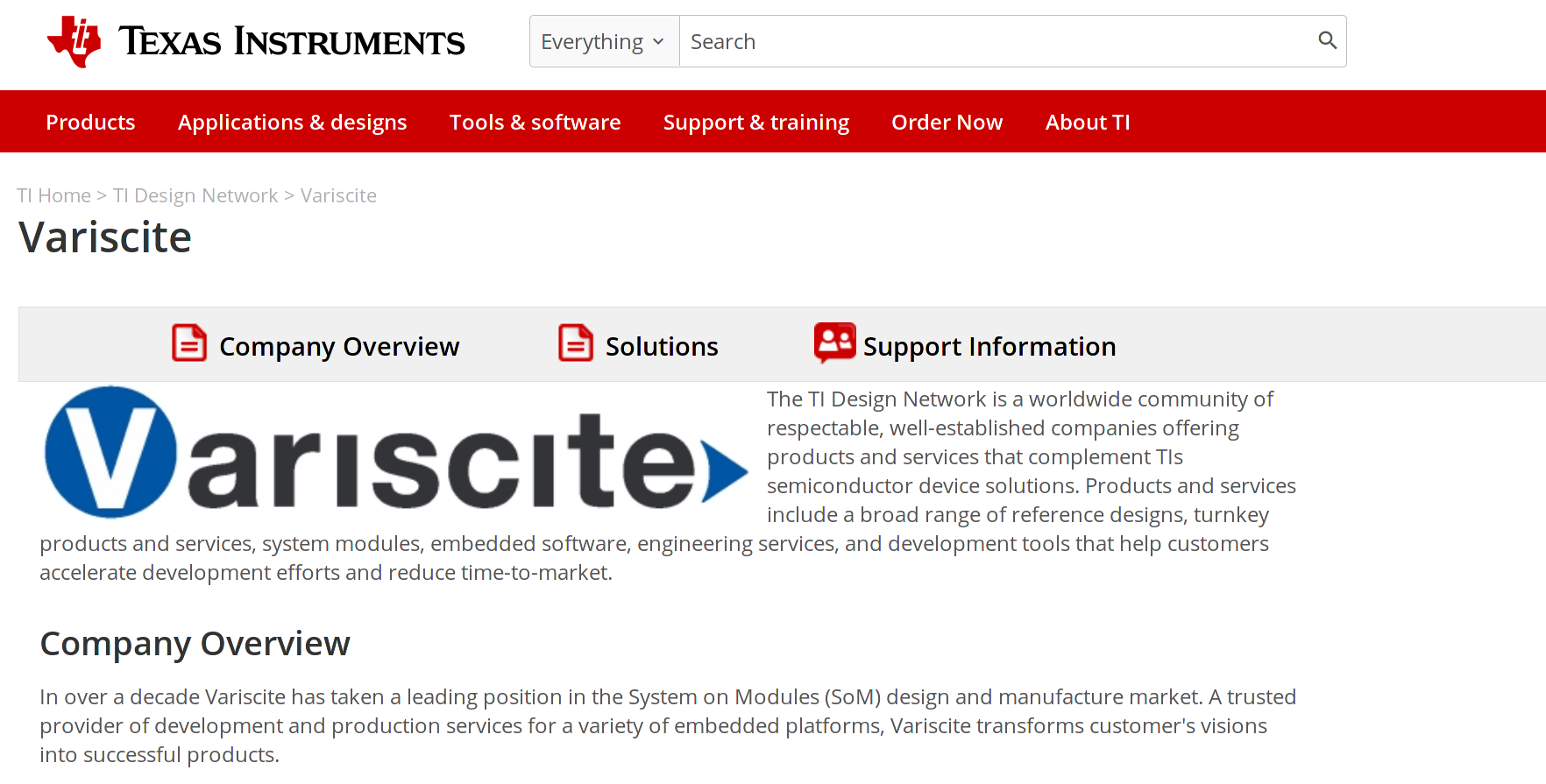

  • Just so I'm understanding correctly, there should be no discussion of any TI products that aren't on official TI evaluation boards?  So for example, no discussion of BeagleBone or LeopardBoard?
    Even if the vendor is a TI partner advertised on the TI site:
    (ti.com/devnet/docs/catalog/companyfolder.tsp?actionPerformed=companyFolder&companyId=5778)
    And all their schematics and documentation are freely available on the site:
    (variscite.com/products/system-on-module-som/cortex-a8/var-som-am33-cpu-ti-am335x-am3354-am3352)
    I understand not being able to speak for Variscite themselves, but what kind of community is TI trying to support if people aren't discussion popular TI platforms?  What does this say to engineers like myself who are developing custom hardware for the TI chips?
    For what its worth, I'm posting on the TI forums because I've been trying for over a week to get into the Variscite forums to no avail.  This is making the alternatives like Freescale and Qualcomm look very appealing!

  • Brad,
    Yes, you are correct. We list the products that our partners have, and here is the disclaimer from TI Design Network page:
    Disclaimer:
    The information contained herein has been provided by a member of TI's Design Network. This information is provided on the TI website only as a convenience and TI is not responsible for the contents of this page or any changes or updates to the information posted on this page. Certain links provided herein permit you to leave this site and enter non-TI sites. These linked sites are not under TI's control. TI is not responsible for the contents of any linked site or any changes or updates to such sites. TI is providing these links to you only as a convenience. The inclusion of any link does not imply endorsement by TI of any linked site.
    TI's Publication of information regarding third-party products or services does not constitute an endorsement regarding the suitability of such products or services or a warranty, representation or endorsement of such products or services, either alone or in combination with any TI product or service.
  • hey Brad,
    One more detail...a friend brought this to my attention that I should have specified TI doesn’t support the board by contributing to the discussion, but the community may read the post and reply....including the Supplier. :) I hope this helps.
