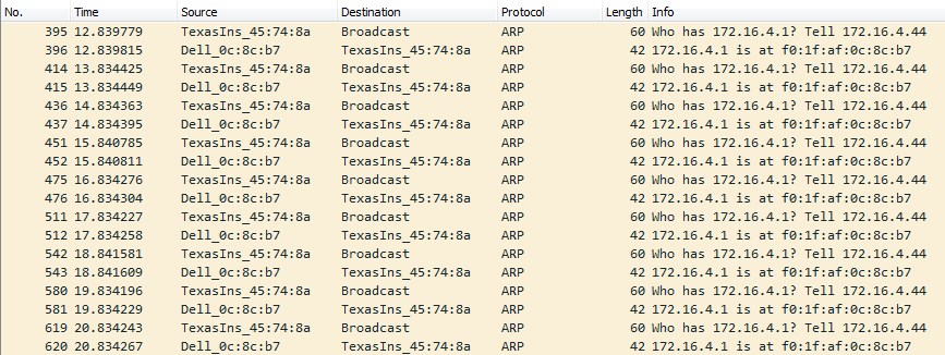

in one of our own designs using an AM3352 and SMSC LAN8710 PHYs for both Ethernet ports, communication on eth0 is fine, but reception on eth1 doesn't seem to work.
When I ping on eth1 an ARP request is sent and received on the other side, but the response doesn't seem to reach the driver.
Through printk outputs in the driver source I found out that cpsw_rx_interrupt() isn't called for eth1, but works fine for eth0.
I've tried Linux Kernel versions 4.4.50 and 3.9.13 with the same result.
Here is the revelvant excerpt from the DTS:

Thanks in advance for any hints that might help me solve this problem.
    Are you aware that eth1 needs to be brought up manually? See processors.wiki.ti.com/.../Linux_Core_CPSW_User's_Guide
    If the issue isn't resolved you can follow this checklist and post the results here: processors.wiki.ti.com/.../5x_CPSW
  • Yes, I'm aware that eth1 has to be brought up manually, otherwise a ping on that interface wouldn't have worked.
    Thanks for the link to the Ethernet Triage Checklist. For some reason I haven't found it before.
    I've retested with the TI SDK and still have the same problem.
    The test were performed as such:
    • ti-processor-sdk-linux-am335x-evm-03.02.00.05-Linux-x86-Install
    • Linux am335x-evm 4.4.32-gadde2ca9f8 #1 PREEMPT Wed Dec 14 18:52:13 EST 2016 armv7l GNU/Linux
    • Arago root file system
    • Custom board (DTS attached); it is using the same clock source for the reference clock of both Ethernet ports (not sure if that's a problem)
    • IP address for eth1 is set manually
    • ARP request issued by ping on eth1 is responded to (see Wireshark screenshot)
    • According to ifconfig zero bytes are received on eth1, but ethtool shows no errors
    • The RX lines from the PHY to the AM3352 show activity, but our 100 MHz oscilloscope probably isn't good enough for further inspection
    Thanks in advance for any help.

    [   16.102748] net eth1: initializing cpsw version 1.12 (0)
    [   16.134826] net eth0: initialized cpsw ale version 1.4
    [   16.140019] net eth0: ALE Table size 1024
    [   16.169504] net eth1: phy found : id is : 0x7c0f1
    [   16.223514] IPv6: ADDRCONF(NETDEV_UP): eth1: link is not ready
    [   16.275333] net eth0: initializing cpsw version 1.12 (0)
    [   16.284156] net eth0: phy found : id is : 0x7c0f1
    [   16.347713] IPv6: ADDRCONF(NETDEV_UP): eth0: link is not ready
    [   19.185570] cpsw 4a100000.ethernet eth1: Link is Up - 100Mbps/Full - flow control rx/tx
    [   19.217071] IPv6: ADDRCONF(NETDEV_CHANGE): eth1: link becomes ready
    [   20.315623] cpsw 4a100000.ethernet eth0: Link is Up - 100Mbps/Full - flow control rx/tx
    [   20.323827] IPv6: ADDRCONF(NETDEV_CHANGE): eth0: link becomes ready
    [   31.610441] random: nonblocking pool is initialized

    root@am335x-evm:~# ethtool -S eth1
    NIC statistics:
         Good Rx Frames: 40
         Broadcast Rx Frames: 4
         Multicast Rx Frames: 14
         Pause Rx Frames: 0
         Rx CRC Errors: 0
         Rx Align/Code Errors: 0
         Oversize Rx Frames: 0
         Rx Jabbers: 0
         Undersize (Short) Rx Frames: 0
         Rx Fragments: 0
         Rx Octets: 5030
         Good Tx Frames: 738
         Broadcast Tx Frames: 229
         Multicast Tx Frames: 70
         Pause Tx Frames: 0
         Deferred Tx Frames: 0
         Collisions: 0
         Single Collision Tx Frames: 0
         Multiple Collision Tx Frames: 0
         Excessive Collisions: 0
         Late Collisions: 0
         Tx Underrun: 0
         Carrier Sense Errors: 0
         Tx Octets: 62886
         Rx + Tx 64 Octet Frames: 255
         Rx + Tx 65-127 Octet Frames: 482
         Rx + Tx 128-255 Octet Frames: 14
         Rx + Tx 256-511 Octet Frames: 27
         Rx + Tx 512-1023 Octet Frames: 0
         Rx + Tx 1024-Up Octet Frames: 0
         Net Octets: 67916
         Rx Start of Frame Overruns: 0
         Rx Middle of Frame Overruns: 0
         Rx DMA Overruns: 0
         Rx DMA chan: head_enqueue: 1
         Rx DMA chan: tail_enqueue: 153
         Rx DMA chan: pad_enqueue: 0
         Rx DMA chan: misqueued: 0
         Rx DMA chan: desc_alloc_fail: 0
         Rx DMA chan: pad_alloc_fail: 0
         Rx DMA chan: runt_receive_buf: 0
         Rx DMA chan: runt_transmit_buf: 0
         Rx DMA chan: empty_dequeue: 0
         Rx DMA chan: busy_dequeue: 52
         Rx DMA chan: good_dequeue: 26
         Rx DMA chan: requeue: 0
         Rx DMA chan: teardown_dequeue: 0
         Tx DMA chan: head_enqueue: 737
         Tx DMA chan: tail_enqueue: 1
         Tx DMA chan: pad_enqueue: 0
         Tx DMA chan: misqueued: 1
         Tx DMA chan: desc_alloc_fail: 0
         Tx DMA chan: pad_alloc_fail: 0
         Tx DMA chan: runt_receive_buf: 0
         Tx DMA chan: runt_transmit_buf: 233
         Tx DMA chan: empty_dequeue: 737
         Tx DMA chan: busy_dequeue: 0
         Tx DMA chan: good_dequeue: 738
         Tx DMA chan: requeue: 0
         Tx DMA chan: teardown_dequeue: 0
    eth0      Link encap:Ethernet  HWaddr 98:5D:AD:45:74:88
              inet addr:192.168.103.4  Bcast:192.168.103.255  Mask:255.255.255.0
              inet6 addr: fe80::9a5d:adff:fe45:7488%132688/64 Scope:Link
              UP BROADCAST RUNNING MULTICAST  MTU:1500  Metric:1
              RX packets:6 errors:0 dropped:0 overruns:0 frame:0
              TX packets:110 errors:0 dropped:0 overruns:0 carrier:0
              collisions:0 txqueuelen:1000
              RX bytes:860 (860.0 B)  TX bytes:9376 (9.1 KiB)
              Interrupt:174
    eth1      Link encap:Ethernet  HWaddr 98:5D:AD:45:74:8A
              inet6 addr: fe80::9a5d:adff:fe45:748a%132688/64 Scope:Link
              RX packets:0 errors:0 dropped:0 overruns:0 frame:0
              TX packets:32 errors:0 dropped:0 overruns:0 carrier:0
              RX bytes:0 (0.0 B)  TX bytes:5052 (4.9 KiB)
    lo        Link encap:Local Loopback
              inet addr:127.0.0.1  Mask:255.0.0.0
              inet6 addr: ::1%132688/128 Scope:Host
              UP LOOPBACK RUNNING  MTU:65536  Metric:1
              RX packets:169 errors:0 dropped:0 overruns:0 frame:0
              TX packets:169 errors:0 dropped:0 overruns:0 carrier:0
              RX bytes:13000 (12.6 KiB)  TX bytes:13000 (12.6 KiB)
              RX packets:22 errors:0 dropped:0 overruns:0 frame:0
              TX packets:388 errors:0 dropped:0 overruns:0 carrier:0
              RX bytes:2320 (2.2 KiB)  TX bytes:30980 (30.2 KiB)
              Interrupt:174
              inet addr:172.16.4.44  Bcast:172.16.255.255  Mask:255.255.0.0
              TX packets:257 errors:0 dropped:0 overruns:0 carrier:0
              RX bytes:0 (0.0 B)  TX bytes:21084 (20.5 KiB)
              RX packets:379 errors:0 dropped:0 overruns:0 frame:0
              TX packets:379 errors:0 dropped:0 overruns:0 carrier:0
              RX bytes:36400 (35.5 KiB)  TX bytes:36400 (35.5 KiB)

  • Hello Biser,
    due to our design using pin U16 for signal rmii2_crs_dv Barebox needed the following function call in our board.c:
    am33xx_select_rmii2_crs_dv();
    Thanks for your help and sorry for the inconvenience.
    it looks like I have the same problem on my custom board, based on AM3352 and I'm using U16 for rmii_crs_dv too. At the moment we are using linux-rt-4.4.32.
    Have I to recall am33xx_select_rmii2_crs_dv() ? where I can find this procedure?
  • Hello Luigi,
    that setup has to be made in the bootloader; in my case Barebox, where this is managed through the am33xx_select_rmii2_crs_dv() function.
    I'm calling it in the board.c file for my hardware, inside the device_initcall.
    If you are using U-Boot I have no idea how the same thing is accomplished there, unfortunately.
    Take care!
