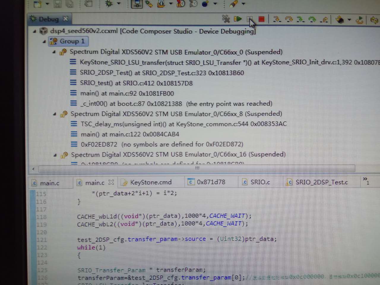

we have a board which have  4 pieces of TMS320C6678.
I am running a piece of code on dsp2 ,which communicate with dsp1 through SRIO and EMAC.
I run the code without breakpoint to test and verify the stability , when I artificially stopped the and Observed, find that showed a message (as shown in picture )
"No symbols are defined for 0xF02ED872" , but Program can continue to run and Looks normal
where and what exactly is the problem? I am using CCS 5.5.0
Thanks in advance,JOB

  • Do you have a map file for the binary running on the C66xx_core8. can you check what section of code is located at location 0xF02ED872?
    who is loading the DSP cores? Are you loading them using the emulator or are they being loaded  by the master core.
    Are all the cores running the same application binary or are they running independent .out files.
    No symbols defined  in CCS just means that the CCS IDE is unable to correlate the assembly code in a particular memory section with any symbols or code from the search path. IF the core is being loaded by some other core or host then you will need to go to Run->Load Program-> Add Symbols and load that out file to see the symbols located at that location in DDR memory.

  • The problem seems to be caused by an interruption that is prone to the problem when the program returns from the interrupt routine.
    The interrupt registration uses the following methods:

    I changed the way to interrupt the registration, using the CSL library function as follow,and the programme runs stable
    registerInterrupt(48 , CSL_INTC_VECTID_4 , &GE_Message_ISR);
    registerInterrupt(20 , CSL_INTC_VECTID_5 , &SRIO_ISR);
    int32_t registerInterrupt(uint32_t event , uint32_t vector , CSL_IntcEventHandler isr)
    hintc[vector] = CSL_intcOpen (&intcObj[vector], event, (CSL_IntcParam*)&vector , NULL);

    I do not know very well about the function CSL_intcOpen /CSL_intcPlugEventHandler/CSL_intcHwControl ,would you give me some reference?

  • All of these CSL functions that you are looking for are provided here:
    pdk_c667x_x_x_x\packages\ti\csl\src\intc
    You can look at the details of the implementation there.
