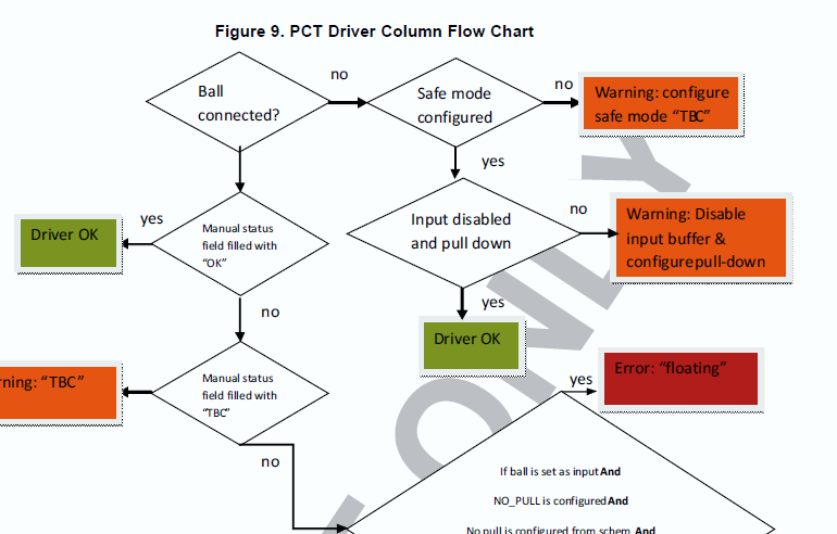

  • David,
    Here is also an excerpt from the "optimization features" logic of the Pad Configuration Tool  that conforms to Stan's suggestion.
    Alex
  • Interesting! The diagram above implies that setting SAFE mode will activate the input buffer automatically because it recommends to DISABLE the input and activate the PULL when using SAFE mode.
    As Stanislav mentioned above, the output buffer is controlled by the selected function. In safe mode, it should not turn on the output buffer but if this is correct, it does turn on the input buffer even it INPUTENABLE is not set by SW? And presumably the Pull cells will be as set by SW.
    Can someone check how the design is implemented to be sure. I am specifically concerned with OMAP5 which is slightly different than J6 ( I had to select DRA74x to post because OMAP5432 is not mapped to a forum).
  • Hi David,
    I don't think the diagram tells us if muxmode=safe enables the input buffer or not. If I'm not wrong, the software check is in place because the previous INPUTENABLE status is simply not known.
    I can check on a OMAP5 board whether muxmode bits alter inputenable, but I'm almost sure it does not.
