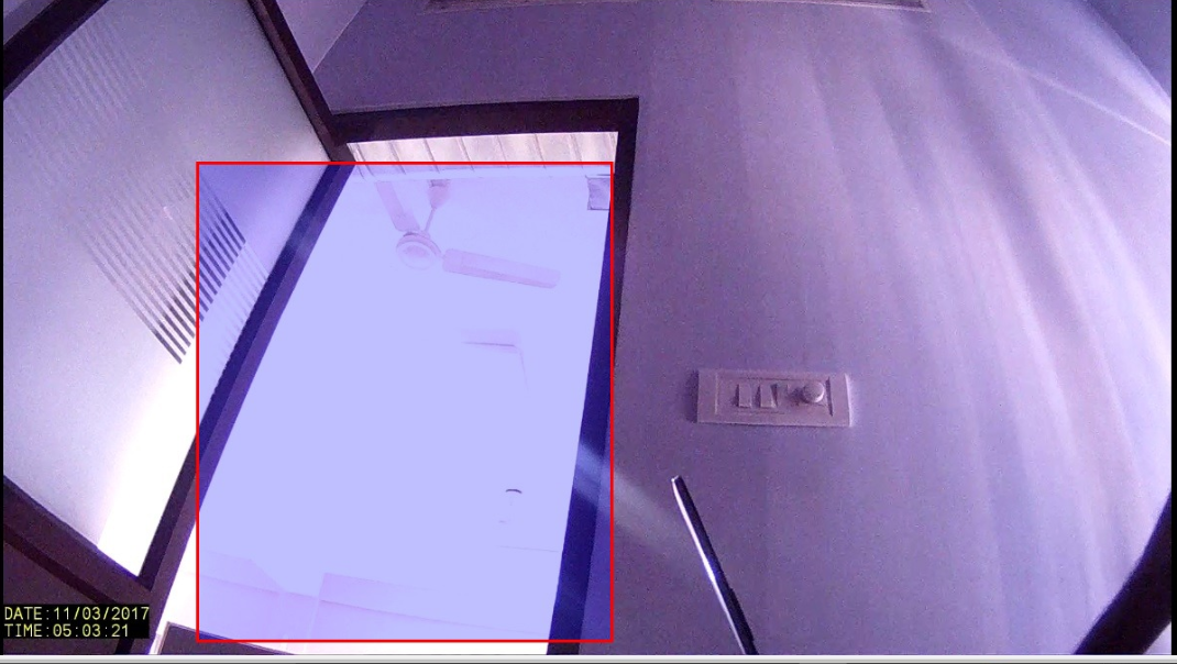

    I have one more clarification on image_partially_over_exposed.
    Is there any specific IPIPE cfg to resolve this?
    RAJ M
  • Hi Raj,
    Sorry for the late reply!.
    First of all you have to verify AE target, and make sure it is not too high. Also you can change the AE metering mode to give more preference to center of the frame. If the pixel is already saturated from senor you can't recover it by ISP processing.
    From SOC side you can try GLBCE module. It can improve the dynamic range of a scene by adaptive tone mapping such that the contents in both the dark and bright regions are visible. One more option is to use data from histogram module and dynamically change GAMMA/GBCE curves to adapt to high dynamic scenes.
    Best Regards
    Nithin Varghese
