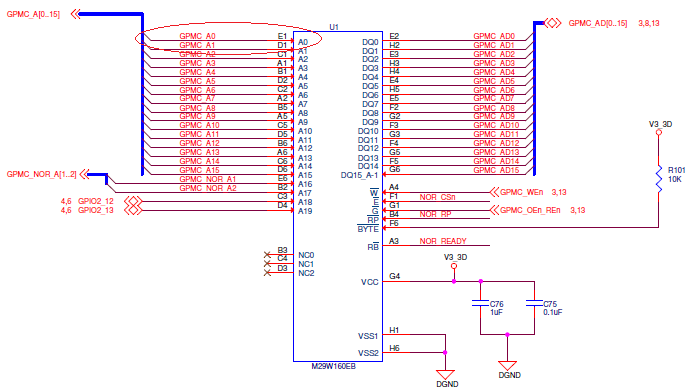

We need a clarification with regards to connecting 16bit NOR-Flash through GPMC.
As per the TRM "Table 7-5" for a 16 bit device, GPMC_A0 is not used whereas in case
of AM335x ICE EVM(TMDSICE3359) GPMC_A0 seems to the connected to A0 of the memory device.
Is there any reason for this connection? Is this a mistake in the EVM design.
In actual design we don't need to connect GPMC_A0 to Memory's A0 pin instead connect  GPMC_A1 to Memory's A0 pin?
