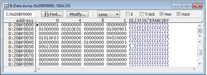

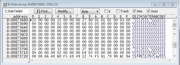

-          The Boot Parameter Table is copied in RAM at @ 0x00873680 which is the memorization address  in RAM by the BOOTLOADER  :
            The memorization seems correct considering the BOOTLOADER works in Little Endian.
-         Hereafter the resulting SPI registers configuration :
            The resulting configuration doesn’t  correspond exactly to the wanted one :
    • wanted C2Delay is 0. In the dedicated SPI register, C2Delay is set to 1.
    • SPI is not in MASTER mode and not ENABLED
   Except to those points, Configuration is available with the used FLASH NOR.

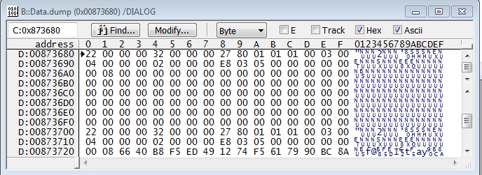

    -          The Boot Parameter Table is copied in RAM at @ 0x00873680 which is the memorization address  in RAM by the BOOTLOADER.
    -          PLL and SPI are correctly configured
    -          The Boot Table is not copied from Flash SPI to RAM (@0x00810000 in Local S2 RAM)
    -          The register BOOTCOMPLETE remains  to value 0x00000000, meaning BOOTLOADER is always active.
    In fact, the BOOTLOADER seems to execute in loop the same part of code and stays always within.

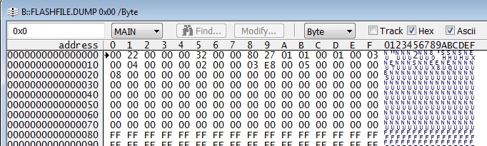

    We don't use Code Composer Studio (CCS) to Flash files data inside the FLASH SPI NOR.  We use TRACE32 with a LAUTERBACH probe.
    We use TRACE32 tools to flash data in aforementioned flash. These tools flash directly raw data byte after byte.  That's the reason why CCS format is not compatible with our process.
    Firstly, we flash the Boot Parameter Table at @0x000000.
    Then and independently, we flash the Boot Table at @0x000800. It must be raw data and not the CCS format.
    Now, I understand why the Bootloader is unable to load our BOOT software in RAM : it's because  up to now, I didn't flash the Boot Table in a raw data format.
    Is my analyzis right ?
