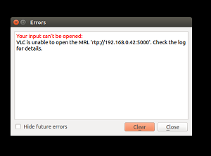

    Here is my use of vlc error message:
    Could you check the log for details as VLC "says"?

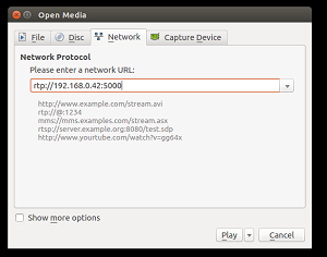

    I tried using vlc on the PC to receive the rtp stream:
         vlc -vvv rtp://192.168.0.42:5000
    vlc debug information is as follows:
    red part of the error message
    [0x7f29b80009b8] main input debug: Creating an input for 'rtp://192.168.0.42:5000'
    [0x7f29b80009b8] main input debug: using timeshift granularity of 50 MiB, in path '/tmp'
    [0x7f29b80009b8] main input debug: `rtp://192.168.0.42:5000' gives access `rtp' demux `' path `192.168.0.42:5000'
    [0x7f29b80009b8] main input debug: enforced demux ` h264'
    [0x7f29b80009b8] main input debug: creating demux: access='rtp' demux='h264' location='192.168.0.42:5000' file='(null)'
    [0x7f29bc000e28] main demux debug: looking for access_demux module matching "rtp": 20 candidates
    [0x7f29bc000e28] main demux debug: net: opening 192.168.0.42 datagram port 5000
    [0x7f29bc000e28] main demux error: socket bind error (Cannot assign requested address)

    So I do not know whether the error is from my sending command or vlc receiving command?
    Could you try to ping PC->board and board->PC.
    If you are using udpsink in gstreamer pipeline could you try :
    vlc -vvv udp://ip:port
    wiki.videolan.org/.../
